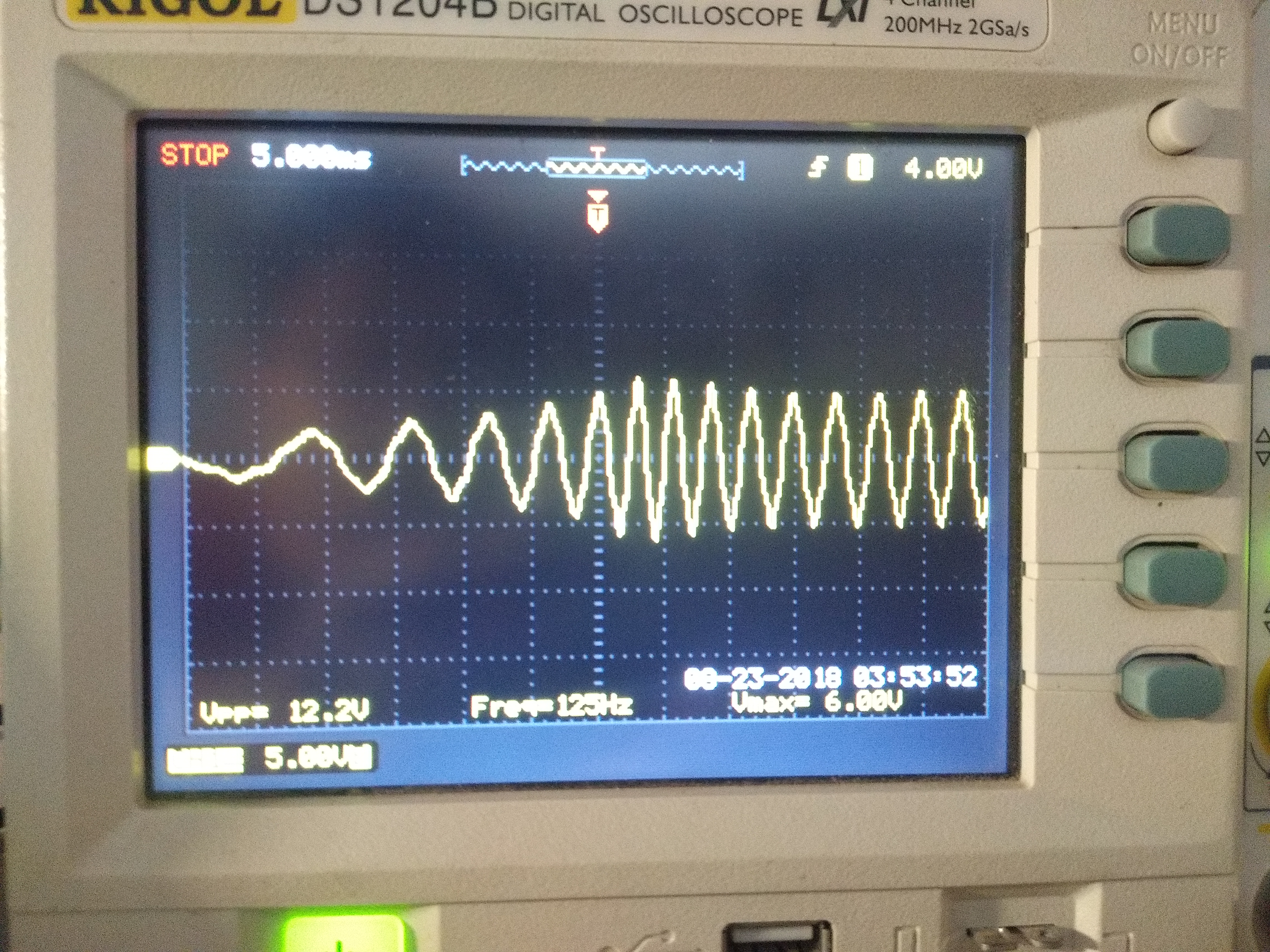

    Unfortunately, I'm having a hard time understanding your code. Can you please tell me the register values in Hex for registers 0x90 through 0x96? You should be able to read the registers back and display the number.
    In addition, I'm having a hard time interpretting the waveform you have sent. Can you tell me what I'm looking at? It looks like a phase current but this is what expected current looks like.

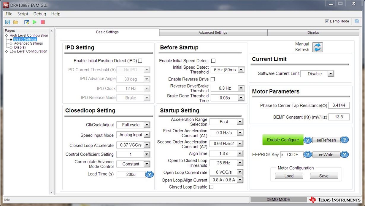

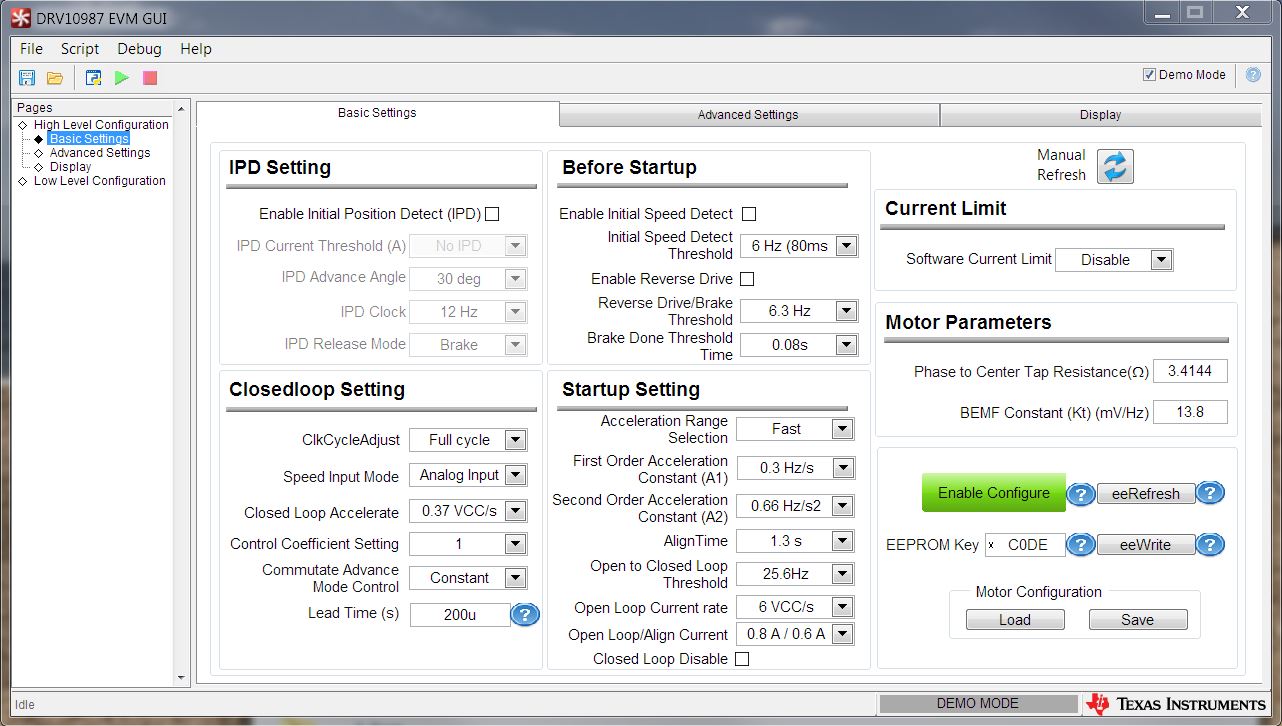

  • Hey Harry,
    I reviewed your settings and I'd first like to comment that reliable start up is usually the most important factor when evaluating the performance of a motor. Usually the next most important factor is fast start up. These two factors conflict with each other. Sensorless alogrithms don't instantenously have information about the rotor position and speed, as a result, it is easier to gather this information when the change in rotor speed (i.e. rotor acceleration) is slow as opposed to fast.
    Looking at the acceleration coefficients, align time, and open loop current rate, it seems like you are trying to quickly spin up the motor to the target speed.
    I would recommend starting with some conservative settings (which I have shown below) that makes the motor more likely to start up. They are slow but you should be able to tune the settings I mentioned above to achieve a faster start up time.
    The hex values for the registers are as follows:
    "DRV10987         0x90      0xC05B"
    "DRV10987         0x91      0xF3A"
    "DRV10987         0x92      0x86"
    "DRV10987         0x93      0x378A"
    "DRV10987         0x94      0x3F0F"
    "DRV10987         0x95      0x7040"
    "DRV10987         0x96      0x7A"
    -Cole

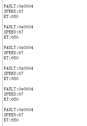

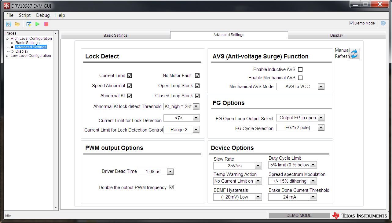

  • Hi Cole,
    I changed chip and using new parameter as recommended and motor start spin. :D
    However,here are some fault as motor.The faultreg sometimes 0x0804 and always 0x0004,which means OverCurr fault and Ktabnormal fault.
    Should I change parameter as turning guide?
    And could you please tell me is Ktabnormal fault important for motor spinning?can i disable this lock bit?
