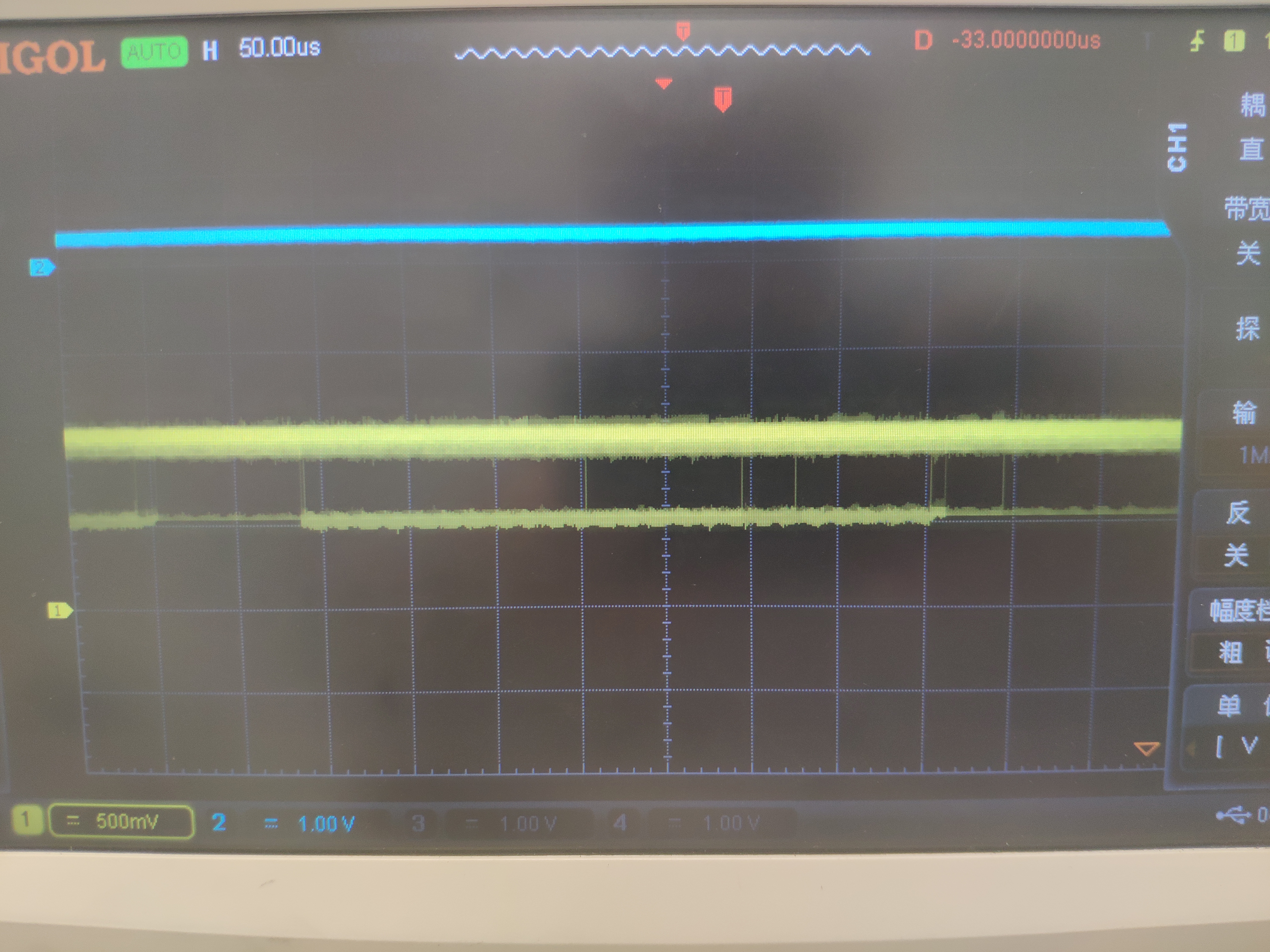

    I followed your instruction by removing resistor R8 R11 and R12 to isolate the DRV8847 from MSP430.
    However, when I try to test with my c2000, I am never be able to observe a high-level on SDA even I wrote nothing in my program.
    So I tested the SDA and SCL port on the EVM directly without C2000. I connected 12V power supply, USB to provide 3.3V pullup voltage and a 3.3V is connected to nSleep .
    This is what I got:
    Both signal is no more than 1 volts. I believe, if the I2C is functional, both lines should show high level. Does this mean the DRV8847 is damaged?
    BTW, is the program firmed on 430 on this board? If I change a new 430, can the GUI download the new program?
  • Weiqi,
    Since you tried driving the MSP430 and the C2000 at the same time, my guess is that the GPIO of the MSP430 may have been destroyed rather than the DRV8847 pins. You may also want to double check the C2000 to see if the GPIO you were using on that device are okay. I think the DRV8847 may be fine because you were likely within the Abs Max values for the device for this condition.
    If you replace the MSP430 on the board, you will need to download the firmware from the EVM page and program it onto the MSP430 using the SPY-BI-WIRE connector (J1) on the board.

  • Weiqi,
    The SDA and SCL lines are pulled up to the 3V3OUT power net. Can you probe the pullup resistors on the board to ensure that the supply is actually at 3.3 V? If it is 1 V, then you may need to supply 3.3 V from an external supply and disconnect the USB. When you do this, check the current from the supply to see if the board is drawing more than you would expect (>50 mA would concern me).
    Also check your C2000 I2C GPIO to see if you get correct voltages you expect there.
    In the meantime, I would recommend ordering another EVM in case you have damaged the current one.
