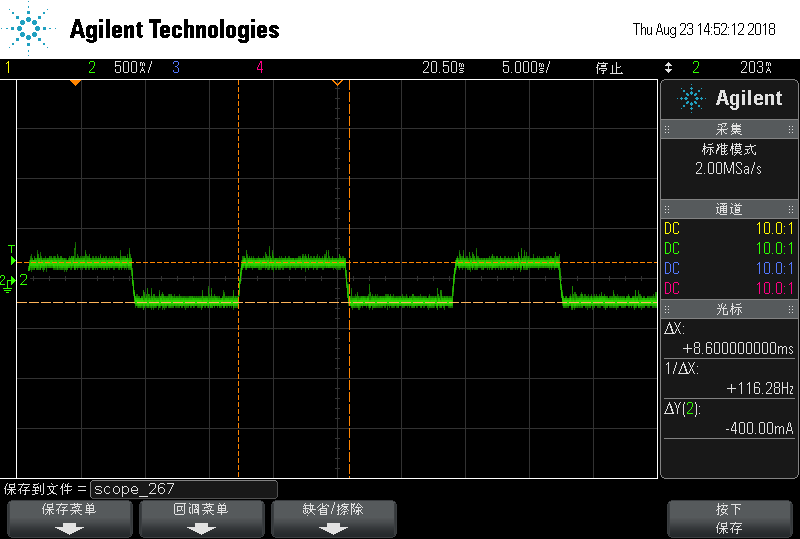

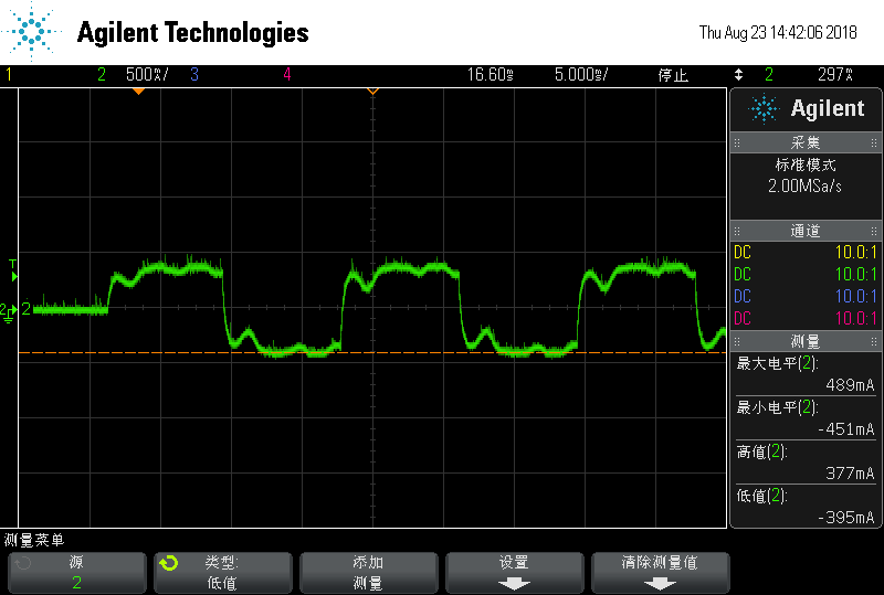

My customer is using our DRV8833 to drive a stepper motor in full step mode. VM is supplied by a 3.7V battery. When the Risense=1ohm, the chopping current should be 200mA and the current waveform is OK. But when they change the Risense to 0.5ohm to make the chopping current to be 400mA, the current waveform is distorted. Please see below picture for the 200mA and 400mA chopping current. Could you please help analyze the root cause? Thanks.

  • Hi Wayne,
    Would you please ask the customer to half the step frequency and observe if the current settles?
    If the current settles, the customer may be experiencing the effects of the motor overshooting the target step and oscillating back to the target position.
    It is generally not a problem, although it can lead to missed steps if the oscillation is too much.
    This effect may be reduced by:
    Using non-circular half step (see a description in the DRV8886 datasheet) or
    considering the DRV8834 in half step mode.
  • Hi Rick,
    Thanks for your reply. Customer also uses the DRV8833 in another project. In that case, the VM=7.8V, chopping current=400mA and the step frequency is much higher than this case. But the 400mA output current in that case is normal. So the current distortion may be not related to the overshooting.
    Is there any possibility that when VM=3.7V, the 400mA is beyond the maximum output current which leads to distortion? In the datasheet, we only have the maximum output current under 5V supply. Do you have the maximum output current data under 3.7V supply? Thanks.

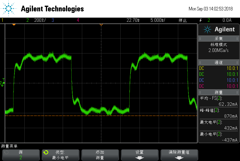

  • Hi Rick,
    The VM is supplied by a battery so it should be stable enough. We also tried to half the step frequency but the 400mA output current still distorted. Please see the waveform as below. Do you have any advice on how we should do next? Thanks.
