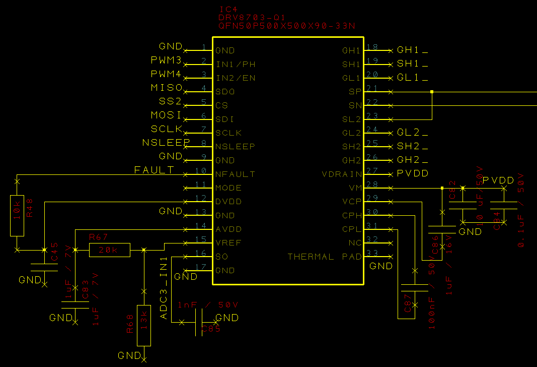

As I have 2 DRV8703-Q1 on my board and I am limited with GPIO's on my uC, I want to connect both fault lines (from both chips). Will this be a problem for any of two chips operation?
I mean if one driver will get into fault it will force FAULT line low - will this cause some undesired effects on another chip which is not fault?
I have connected NFAULT line pulling it high to dvdd line as you see from picture below on both chips.
