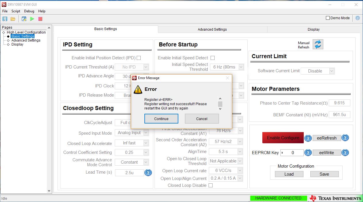

But now as Iam trying to connect, it gives an error message which reads:
DRV10983 USB2ANY.lvclass:Write Register.vi<ERR>
Register writing not successful!! Please restart the GUI and try again

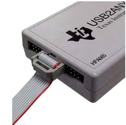

     -USB2ANY is connected to computer through usb and connected to evm through I2C connector
    make sure the ribbon cable is connected in the center of the USB2ANY like so:
    Formal reference for setup can be found on our Quick-Start Guide (http://www.ti.com/lit/ug/slyu022c/slyu022c.pdf

    5) When you get the error message, press "Continue" to clear the window. Then press "Enable Configure" button. To make it green. If you don't get the error message again, you can continue working. Otherwise we have to explore the problem further.

    The evm gui will give that error message as long as the board doesn't have the expected voltages on Vcc, Vreg, V3p3, V1p8, so let's focus on the board.

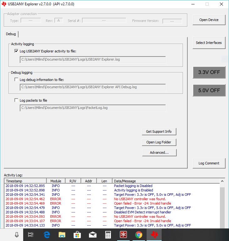

    But now as I am connecting the USB2ANY  with laptop, I am unable to get any voltages at these pins (all are zero volts.)
    And as I disconnect and reconnect the USB2ANY , the USB2ANY gives me following error messages:
