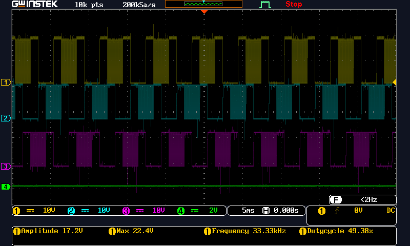

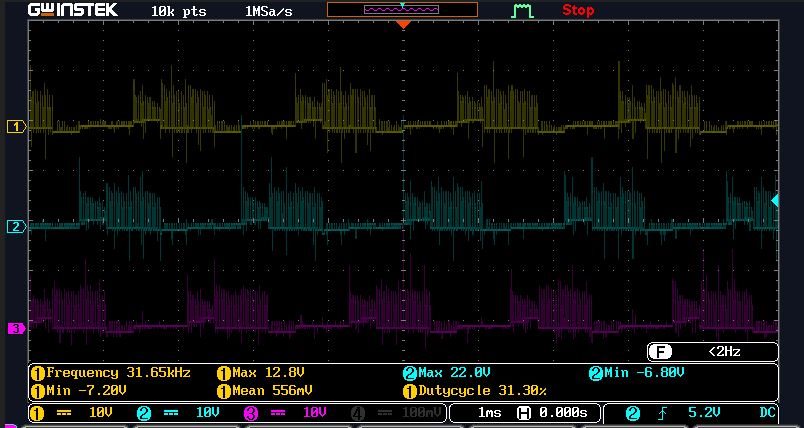

    Please help me with 6-mode input signal, waveform below shows the output in 1-mode and 6-mode
    MOSFET output in 1-mode
    output in 6-mode
    channel-1 is MOSFET output from  phase-A, channel-2 is input to AH and channel-3 is input to AL.
    I want to know how to give input in 6-mode.
    Rashi
  • Hi Rashi,
    I'm not sure I understand the question you're asking here, can you try to clarify?
    In 1xPWM mode, a single PWM signal is applied to the INHA pin, and the DRV8305 uses an internally stored commutation pattern to turn on/off the three high side and low side gates based on the state inputs of the INLA, INHB, and INLB pins.
    In 6xPWM mode, each high side and low side gate output is controlled directly by its respective input pin (INHx/INLx), so the commutation pattern must be provided by the MCU for each gate.
    Garrett

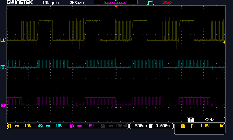

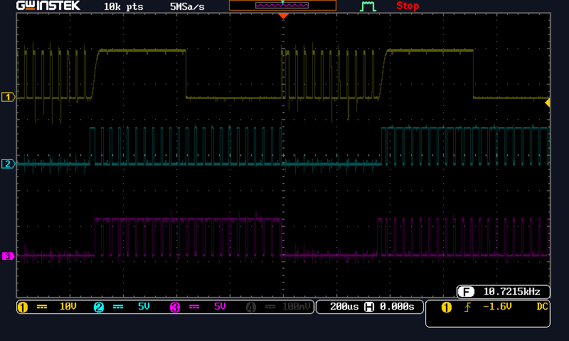

    here output waveform, i.e at pins(SH_A, SH_B and SH_C), attached below
    When load is not connected
    When load is connected
    Rashi
  • Hi Rashi,
    1) Can you read back any fault codes when the motor stops spinning? If the gate drivers are disabled there will likely be an associated fault causing this to happen
    2) Is this happening on multiple units, or just one? If it's just one, I would suspect that maybe a manufacturing defect caused a short between some of the pins. If it's happening on multiple units, then the issue is more likely systematic. What is the voltage rating on your capacitors connected to VCPH, CP1H/CP1L, and CP2H/CP2L?
    Garrett
