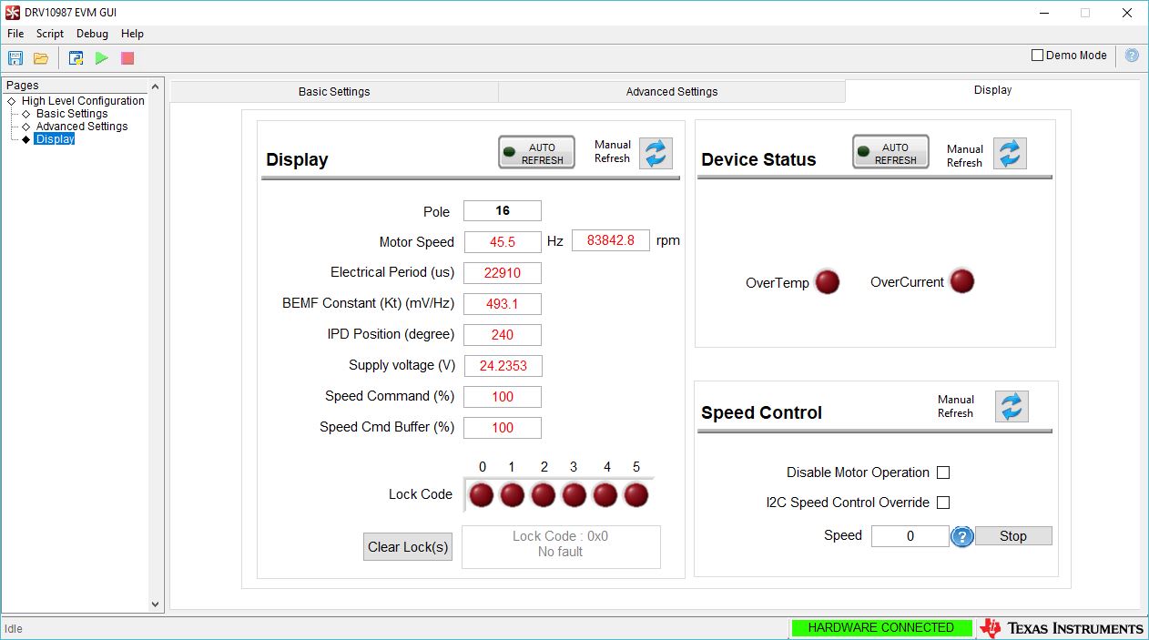

    1) I have calculated Kt (= 400 mV/Hz) as per Tuning Guide, however, as I look into the GUI Display Tab, the calculated BEMF constant Kt displayed is 306.4 mV/Hz and also the speed in rpm displayed is several times higher than the motor speed in rpm
    2) The motor start-up time has reduced ( owing to disabled current limit for lock detection ) as it was going through multiple On-OFF cycles. Still it displays Lock Code 0 .
    Also further as I enter into the closed loop operation, it immediately shows, Lock code 1 and 2 are also activated.

    1.  Also the speed in rpm displayed is several times higher than the motor speed in rpm
      1. Unfortunately, this is a known issue with this version of the GUI, we plan to release a newer version to fix the calculation. If you do the calculation by hand you should be able to look at the electrical frequency box and use the equation to calculate it
        RPM = 120*f_electrical/n_poles

      1. Just to be clear, we are talking about those locks appearing after spending some time in closed loop, not necessarily right when the device tries to enter closed loop, right? Lock 1 and 2 are both related to the programmed Kt again, I'd like to just confirm that the Kt_calc (shown on the GUI) closely matches the Kt_prog (the value in manually placed in the box on basic settings tab) leading up to the Lock 1 and Lock 2 activation.
      2. If both Kt's match, then we need to make sure Tcontrol is tuned the RPM right before the triggers occur. If they do not, then manually match the Kt_prog to the Kt_calc.
    If this keeps happening then we'll need to gather some waveforms and see what the phase current and voltage is doing.

    1.  During both  Open loop and Closed Loop operation, the actual speed measured and the speed calculated using formula (speed = 120*f_electrical/n_poles) does not match.
      1. I should have been given a little bit more context. We expect up to a 7% mismatch been the actual motor speed and the electrical frequency box in the GUI. If the period box is used, the mismatch goes down below 1% (RPM = 120/(n_poles*T_electrical*10^-6)). Alternatively, measuring FG frequency with an oscilloscope should yield the most accurate value for the speed of the motor (because FG is the actual commutation frequency).
      2. Because of delays in GUI calculation, I trust measuring FG and plotting it over time the most, and then the GUI in closed loop only

    2) The DRV10987 does not indicate "prototype silicon". I simply followed your suggestion : " If the programmed and measured value are different, keep "chasing" the measured value by changing the Kt value until they are the same ". Now the voltage displayed is as per attached file GUI Screenshot.
    Now my only concern is that the motor speed control is limited as follows:
    Lower Limit  27.6 Hz  i.e 207 RPM for any GUI Speed Command  below 280
    Upper Limit 45.2  Hz  i.e 335 RPM for GUI Speed Command 511
