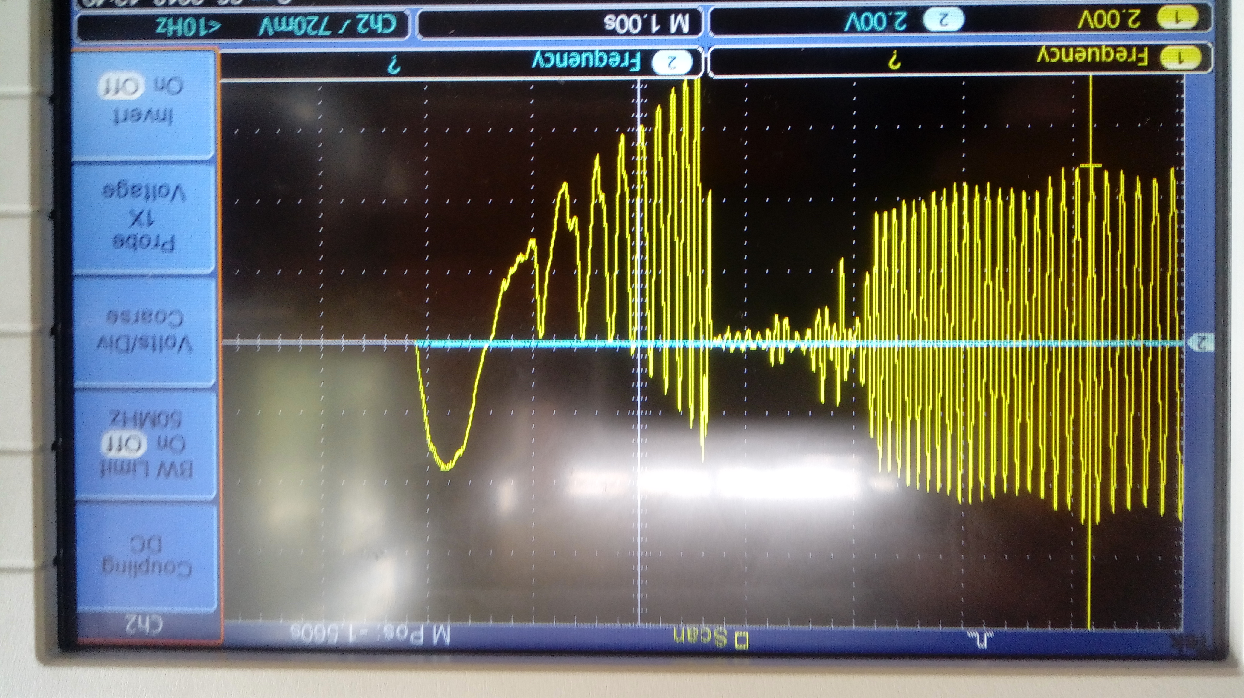

  •  The above image is current waveform the volt per division is 2 V and i have used a current probe with 3 turns so basically the volt per division is 0.66. For 30% duty the system start goes to threshold open to close loop frequency and then goes to close loop and stops and if i check the fault and status registers the fault register is 0x00 and the status register is 0x0F. So, the system is not in fault or lock but the motor stops.
    The below  image is current waveform the volt per division is 2 V and i have used a current probe with 3 turns so basically the volt per division is 0.66. For 40% duty the system start goes to threshold open to close loop frequency and then goes to close loop and stops and if i check the fault and status registers the fault register is 0x01 and the status register is 0x1F. So, the system goes to overload current fault and stops but i have kept the limit maximum and in waveform the current doesn't reach its limit.
    The 3rd image is current waveform the volt per division is 2 V and i have used a current probe with 3 turns so basically the volt per division is 0.66. For 60% duty the system start goes to threshold open to close loop frequency and then goes to close loop and stops and if i check the fault and status registers the fault register is 0x00 and the status register is 0x0F. So, the system is not in fault or lock but the motor stops.
  • Jeet,
    Thanks for the scope images. They are very useful.
    It looks like open loop operation is fine, but there is an issue when going to closed loop.
    2 Things I would try.
    1. Is there a reason you've set the control coefficient to 0.5? I would leave that at 1.0.
    2. I would adjust the lead time. I suspect that when we go to closed loop the lead time is not correct and we start miss commutating the motor and result in driving phases incorrectly which leads to high current.
    Brian

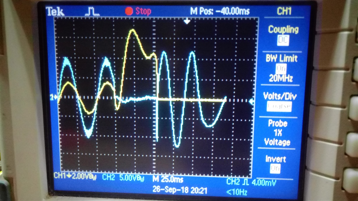

    4. i am attaching an image, in that image the voltage per phase ( blue)  and current line current for star system (yellow)  waveform is available. can i know why does the voltage shuts down and current shots up? this is the operation when i am in open loop i shift to close loop and after coming to close loop i provide 65% duty and system runs for 5 seconds and the failure occurs.

    4. I'm confused as to why your voltage is below ground? I would expect a PWM with varying duty cycle to generate a sinusoidal current. Until I understand the phase voltage I'm not able to comment on the phase current.

    Thank you for timely replies. With regards to our previous conversation, i have changed my control coefficient to 1 for open and close loop and the results are same. I will explain my system, initially my system is in open loop with current 0.8 (open loop current setting) but it consumes 1 A current if i see through oscilloscope. My system changes from open loop to close loop with handoff frequency of 12.8 Hz ( if i check through oscilloscope the frequency is 12.1 Hz) and with 65% PWM duty. System in close loop with 65% PWM duty spins for 5 seconds and shuts down with the same image as i have send above ( image with voltage and current waveform).
    The voltage waveform is sinusoidal as i have used RC filter ( cutoff frequency 5kHz). And we can see the voltage is in phase with current.
