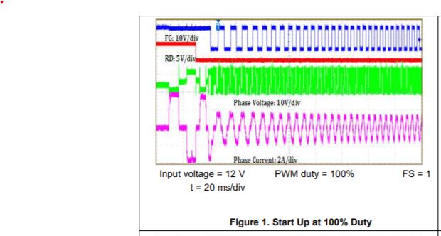

    1)  Please double check with oscilloscope on all the phase voltages of the motors that there is no attempted alignment pulse. The current of 40mA is way bigger than the 5mA supply current and signifies either the motor is trying to start the motor or something is damaged in the chip. What could be happening is that the motor tries to align but immediately hits Over Current protection because of the low resistance of the motor, and it happens so fast that it seems the motor doesn't move and align.  It might be unlikely but just double check.
    2) I think it would help a lot if you could share with me the oscilloscope waveform of what happens when starting the motor. Compare it to the typical startup waveform below that I got from the DRV11873 datasheet (www.ti.com/.../drv11873.pdf). I know you said nothing happens, but it's be good to actually see an oscilloscope capture to make sure.
    3) In general, compare the signals of the working units with that of the non-working units, and see if you find any differences.
