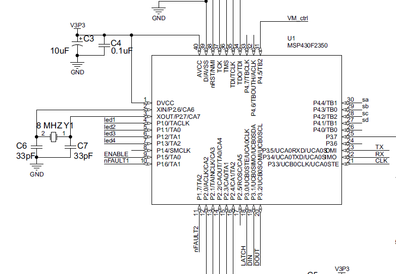

Hi, i have a Question regarding the interfacing of the DOUT to a 3.3V µC.
On the Datasheet the DOUT has a pullup to internal 5.7V with 1.4k.
On the customer evaluation module, DOUT is coupled directly to a MSP430 input regarding SLVU976–September 2013.
Doesn't this influence the functionality of the MSP430 due to a permanent current flow through the internal clamping?

    DOUT is connected to MSP430's P3.2 pin which can set an internal pull-up for DOUT.
    Since MSP430 can support this function, I don't have any concern.

    The internal Pullups of the MSP430 are typical 35k, the Pullup in the DRV8860 is 1.4k, so the Voltage on the Pin goes over VDD and will be truncated by the internal Clamping of the MSP430.
    That's what makes me wonder why they dont use a divider or some Kind of voltage Translation.
    I know from the C2000 that you have issues if you let current flow through the clamping, f.i. false measurements on other anlog Inputs.
    Thats why i'm sceptical in this case.
  • Christoph,
    You are right. For a final application circuit, a 2.2kohm pull-down resistor on DOUT should be added to bring the voltage level to a normal range. Also, to make sure no back drive current, you can put a diode between MSP430 and DRV8860 DOUT.
    On the EVM, MSP430 internal has a diode between P3.2 pin and DVCC which can handle 2mA. So, it doesn't get a trouble.
