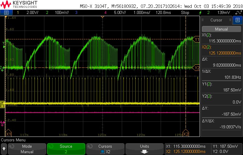

I am using a DRV8825 to drive a step motor. it is 1.8degree, 12V,  rated current is .25A. phase resistance is 48 ohm. phase inductance is 17mH. holding torque is 380g.cm.
yellow trace is step, roughly 6Khz. green trace is isense pin. reference voltage is 1V, Rsense is 1.5ohm.
looks like the current waveform is not very pretty. any idea to optimize the design.

it works but sometimes makes noise.
  • Hi David,
    May I suggest the DRV8846 as an alternate device based on your stated voltage and current. The device has a maximum operating voltage of 18V and has many additional decay modes available that may clean up the current. The DRV8846 has a mode that automatically adjust the percentage of fast/slow decay to maintain current regulation.
    A DRV8846EVM is available for evaluation.
    If you need to continue with the DRV8825, please provide/confirm the following settings
    microstep settings (is it 1/8)
    decay mode (is it mixed)
    If you are using mixed decay, please try fast decay.
  • Hi, Rick
    Thank you very much for your prompt response, we'd like to try DRV8846, but this DRV8825 is on a released product, the vendor recently updated the motor, that introduced the problem.
    the microstep setting is 1/16. fast decay.

  • Hi David,
    Thanks for the information.
    As an experiment, can you try raising VREF to 2.6V and increasing the sense resistor to 4 Ohms? This will provide a little more headroom to the current sense comparators between steps.
  • Thank you for the suggestion, I will give it a try.
