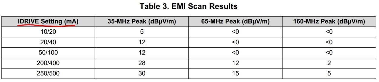

I was study the application note SLVA714B: Understanding IDRIVE and TDRIVE in TI Smart Gate Drivers, i was wondering that what is the meaning of the IDRIVE setting in below tables, does the 10/20mA means sink/source current?
