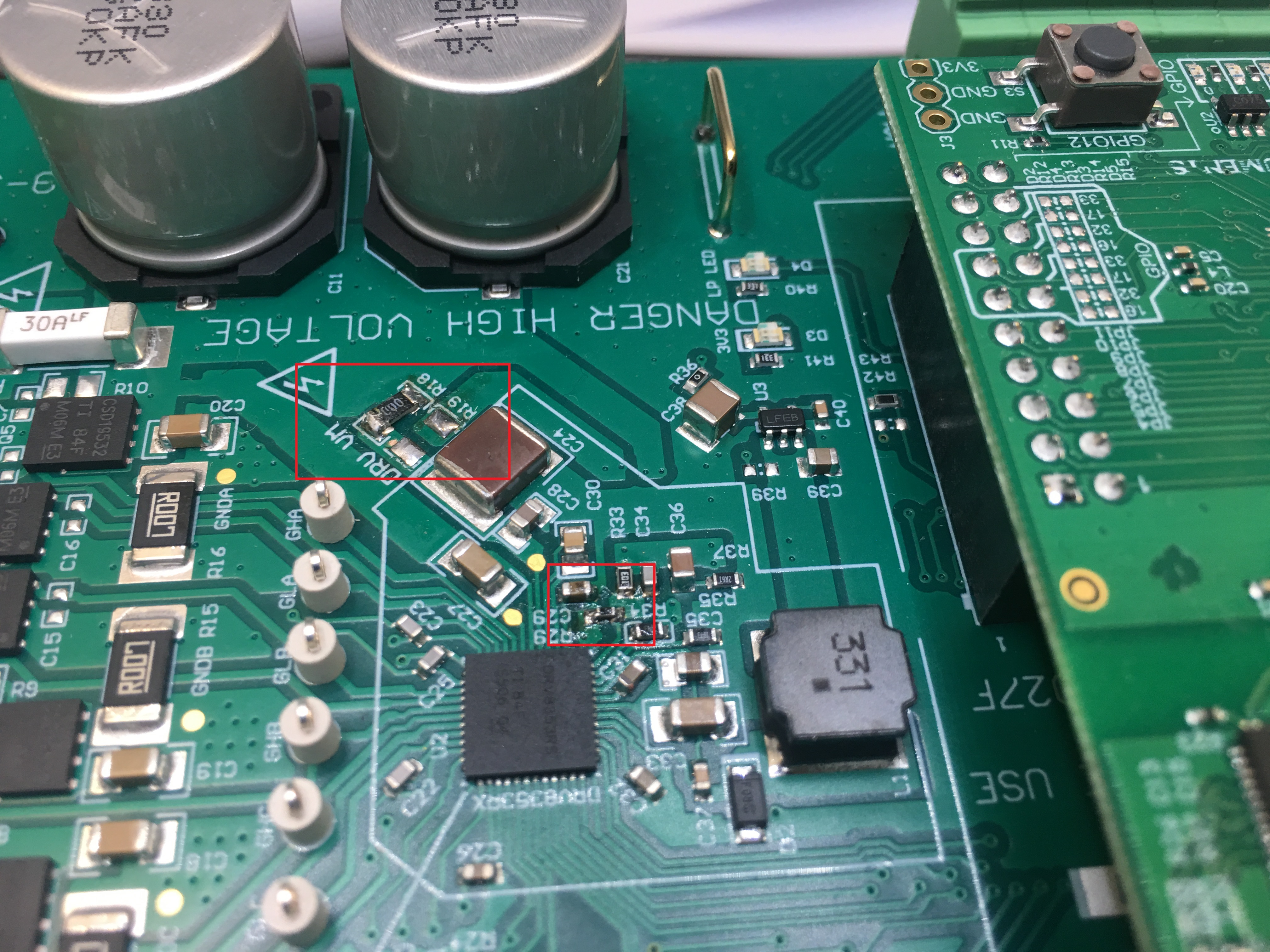

 Then I wanted to change the operating mode of the Gate Driver from “Split rail” to “Single rail”. Therefore I by replaced of resistor R19 and R18. (see picture)
I checked the change by measuring the adapted voltage at measure point of Vm (TP16).
Again the drive identification and the speed control mode worked fine.
The next step was to adapt the buck regulator from 12V output to 5V output. I changed the Resistor R29 ( from 2,61k to 10k). (see the above picture)
I checked the hardware changed by measure the voltage directly at the Vbuck.

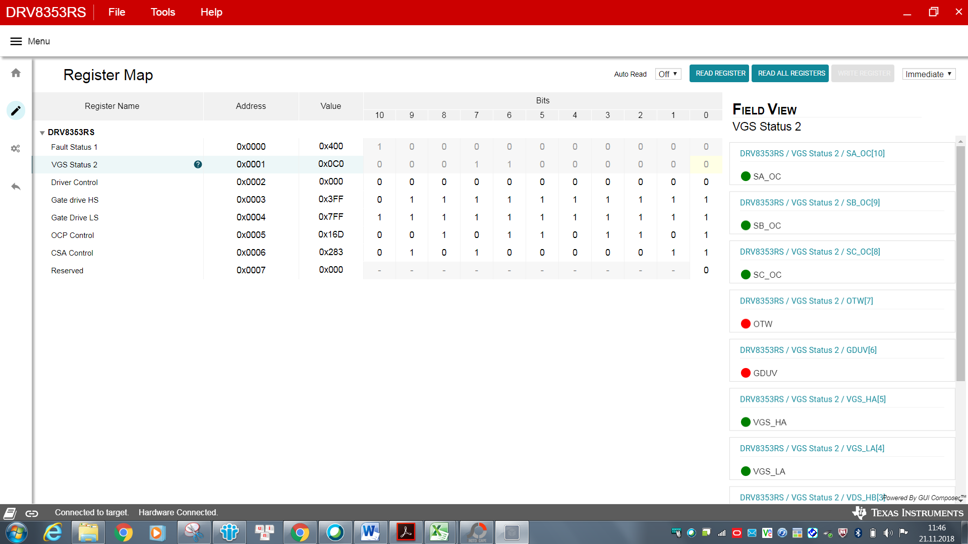

After connecting the BLDC drive to the board and starting the drive identification, after a time less than one second the procedure stopped. The error “GDUV” occurs. I was not able to acknowledge the error. After a reboot the board trips again.
I after supplying the board (without activating the demo application) I measured the high and low side outputs of the gate driver. The high side Mosfet of phase A and B are switched on (VDC = 48V). The high side Mosfet of phase C is low (3.3V).
The nFAULT-LED is lighting up. Based on the register report on program DRV8353Rx 1.0.0, I suspect the error is due to VCP- Charge pump under voltage, and over-temperature warning. You can see these pictures of register report above.
I have also measured the voltages VM, Vcp, Vgls, Vcc and Dvdd. Only the charge pump voltage Vcp is not good. This is 42,2V (VM+2V), although it’s supposed to be VM+10,5V as a recommendation. And Vcc = about 7V (not 3,3V).

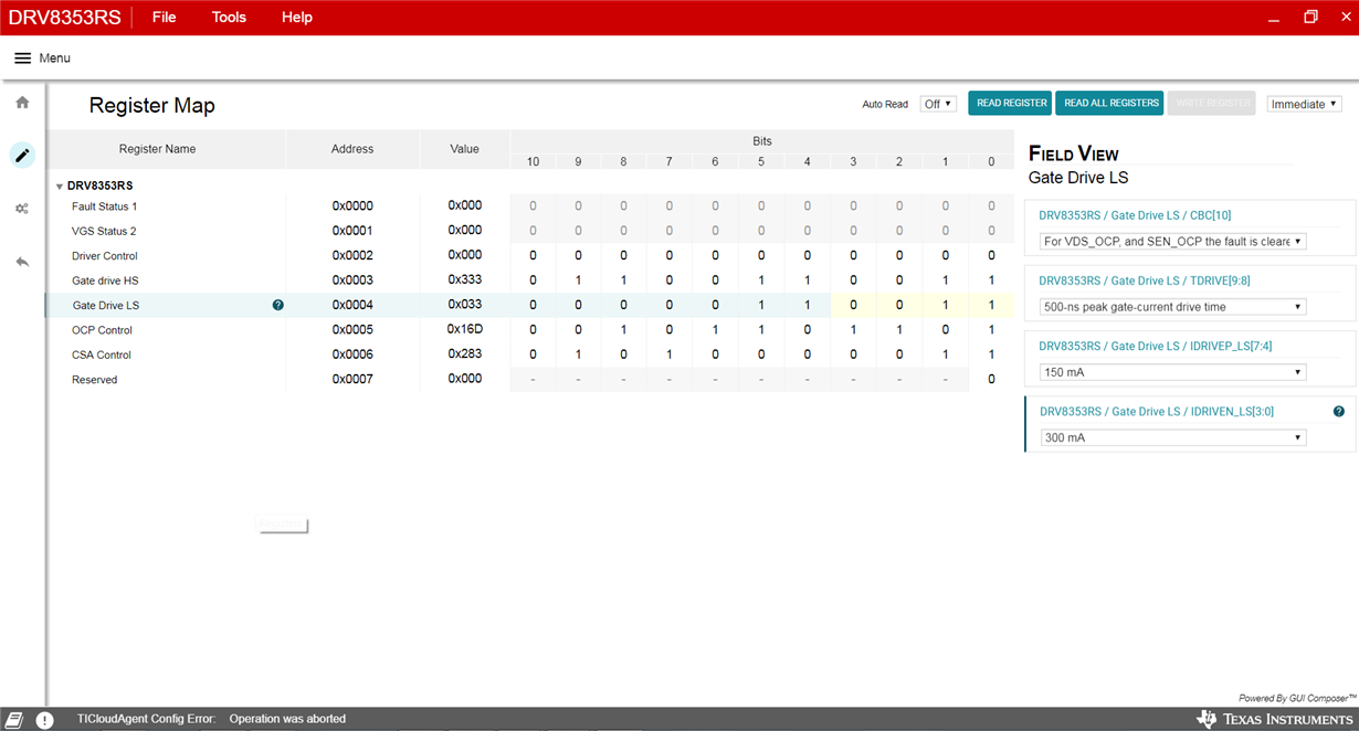

    The likely problem is that the EVM board and associated firmware have the iDrive settings at MAX by default. This is incorrect. The TI NextFETs that are on the EVM only need low iDrive since they turn on so easily and have a low Qgd value. What we should have done and are implementing now is to have the iDrive at a more conservative value closer to the minimum.
    The issue you are likely seeing is that the DRV has become damaged as the slew rate of an internal node near the gate drive output ramped too quickly unnecessarily because the iDrive setting was too high and damaged the DRV internally. Higher iDrive is only needed/useful when using FETs that have a higher Qgd.
    Although not very common, we are seeing more cases of this issue recently. The firmware team is making the changes to the code now and should have it updated soon. In the meantime if you receive another EVM, please lower the iDrive yourself in the GUI before enabling the driver.
    We recommend the following, please make these changes Before enabling the driver:
    0x03 bits [10:0] written as 0x333
    0x04 bits [7:0] written as 0x33
    This unlocks all registers and then sets the gate drive for HSP/LSP to 150mA, sets the HSN/LSN to 300mA.

    And from start I changed the register map as what you wrote me last time, although with these settings are “rise time” and “fall time” 10 times longer than in data sheet of “CSD19352 MosFet”. For Gate drive HS and LS:
    0x0003: 0x333
    0x0004: 0x033
    Operating voltage of this board is first set to 36V.
