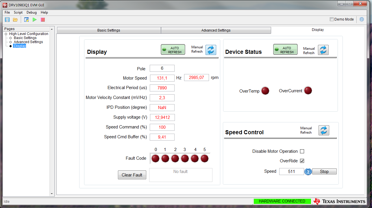

  •  Hi Cole thank's for answer.
    Now the motor work but the max speed is very low.
  • Hey Giovanni,
    Looks like the speed command % (speed you want) doesn't match the speed command buffer % (what the driver outputs to the motor). You have 3 options:
    1). Increase Software Current Limit (SWiLimitThr[3:0])
    2). Increase Kt and see if the speed gets faster (KtValue[3:0] and KtShift[2:0])
    3). Disable software current (SWiLimitThr[3:0]) and make the closed loop acceleration slower (ClsLpAccel[2:0])
    Let me know if any of these help.
