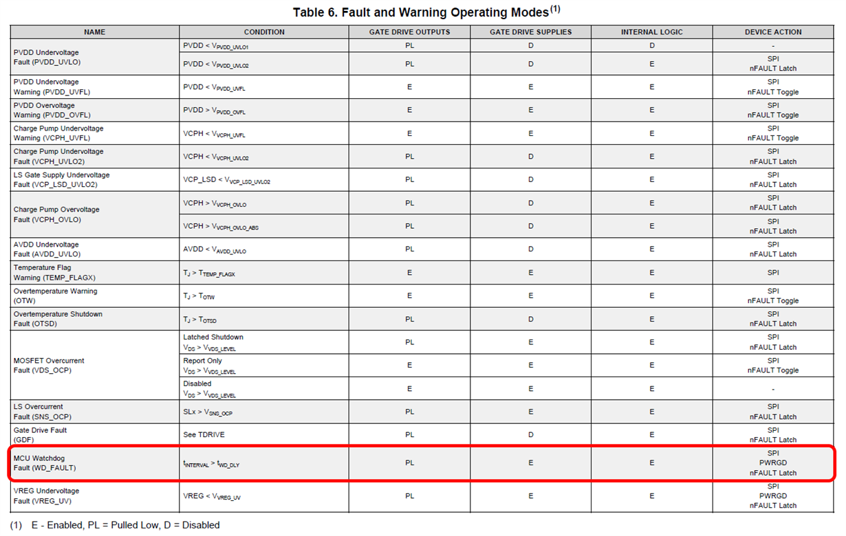

The datasheet described on once the watchdog fault occurred DRV8305-Q1 & gate driver are put
into a safe state. However, the detail of the safe state is not explained the detail .

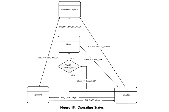

I wonder the safe state means the Standby mode on Figure 16. Operating States?
Please give your advice.
