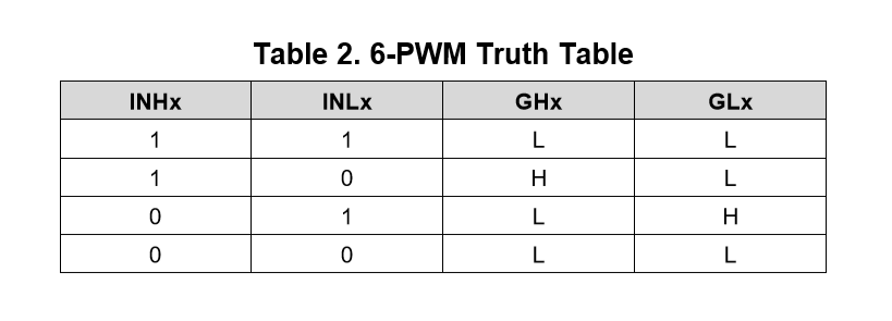

Dear, Sir.
My customer would like to all high-sdie FETs= OFF & all low-side FET's=ON itilizing
6-PWM mode.
I think;
INHA=0, INHB=0, INHC=0 & INLA=1, INLB=1, INLC1 setting could be met with ther
expectation, but I would like to dpuble-confirm.
