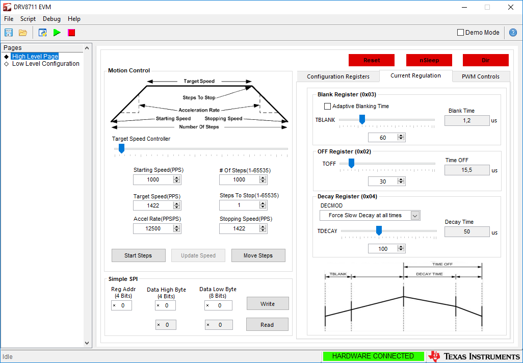

Recently I've gotten my hands on a DRV8711 EVM and been attempting to tune the settings in such a way that it can drive a stepper correctly.
I'm using this stepper here.
Might be a bit rough to see, but I'm using a 103H7823-1740 stepper.

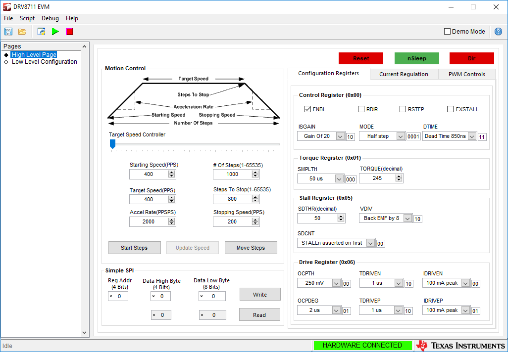

After consulting your quick start guides and datasheets I've settled for the following settings.
But the problem that I'm facing, is that the motor is incredibly loud, to the point of major annoyance.
Could you perhaps provide some insight how to reduce the noise levels?
Thanks in advance!
Thom

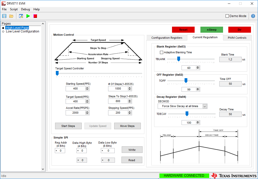

    I've been busy attempting to find the correct settings and it appeared that microstepping + Slow/Mixed (Indexer Mode Only) gives by far the best settings. Calibrating is very painful as there are a lot of variables to tweak, but I settled for TBLANK=50 and TOFF=40 with TDECAY scaling with the speed.
    For example I have a "slow" speed of 0.111 rps, the best TDECAY with this setting is actually flat 0, but the "fast" speed of 1.333 rps requires a higher decay, TDECAY = 41. Having a too low TDECAY produced a highly audible low "humming" noise, overshooting the TDECAY by too much result in a whining noise, there truly appears to be some kind of sweet spot.
    All other "modes" simply do not work for me as, no matter what (practically), the noise is unbearable.
    I wouldn't consider this resolved, having to manually tweak these settings for every speed is a massive chore, isn't there a better way about this?
    Thom

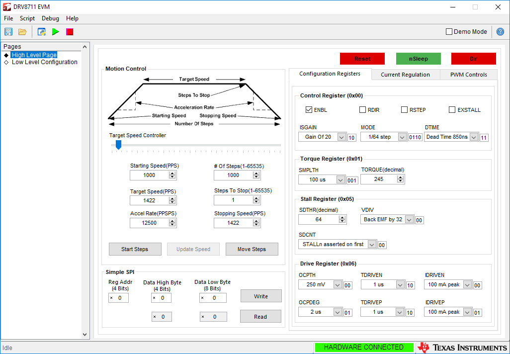

    First, 40us or 50us Toff time plus the time of driving the winding current to regulation point can cause the winding current ripple frequency lower than 20kHz. So, we can hear it. Would you try to reduce the Toff time to 30us?
    Second, you use half step setting. Could you increase to 32-step or 64-step setting which can have a smooth motor motion and may reduce the audible noise.

    I tried the following settings:
    The speed is set to the lowest necessary, with these settings I can choose between a woodpecker (Force Slow Decay at all times) or a high-pitched whining noise ( all others ).
    Thom
  • Thom,
    Since we don't have the current probe to monitor the current waveform, I just try what we think the best and cannot verify it.
    1. If tBLANK is too long with a small winding inductance, that may give us a higher peak current and extend the cycle time to audible range, if you change the tBLANK to 1us, does it affect the noise?
    2. In your setting, the Tdecay setting is much longer than Toff setting. Can you make Tdecay < Toff and aggressively reduce the Toff to 10us?
    Do you get noise sound with auto-mix decay?
