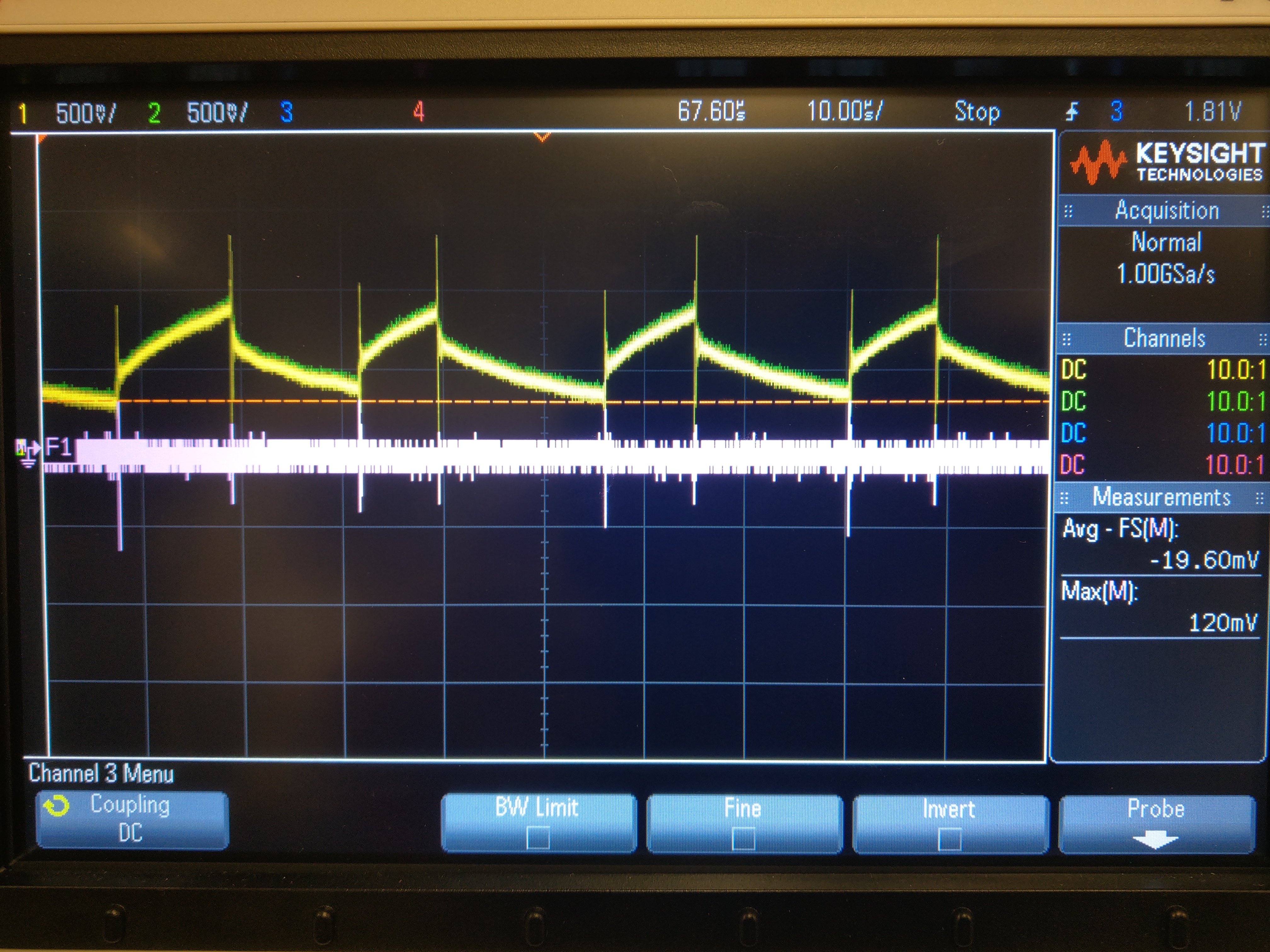

    I've attached 2 captures. The yellow and green lines represent the voltages measured on either side of a shunt to the motor.
    The purple line shows the difference between these 2 probes, or effectively, the voltage across the shunt resistor.
    The values can be seen on the right side under "Measurements"
    The value of the shunt resistor is 0.01 ohms.
    This image was captured when stalling the motor at 100% PWM. The shunt resistor shows a voltage of 49mV (50mV for simplicity). This equates to roughly 5 Amps to the motor. (0.05 / 0.01)
    This image was captured when pulling the same weight, but running at 99% PWM. The 120mV equates to about 12 Amps to the motor. (0.12 / 0.01)

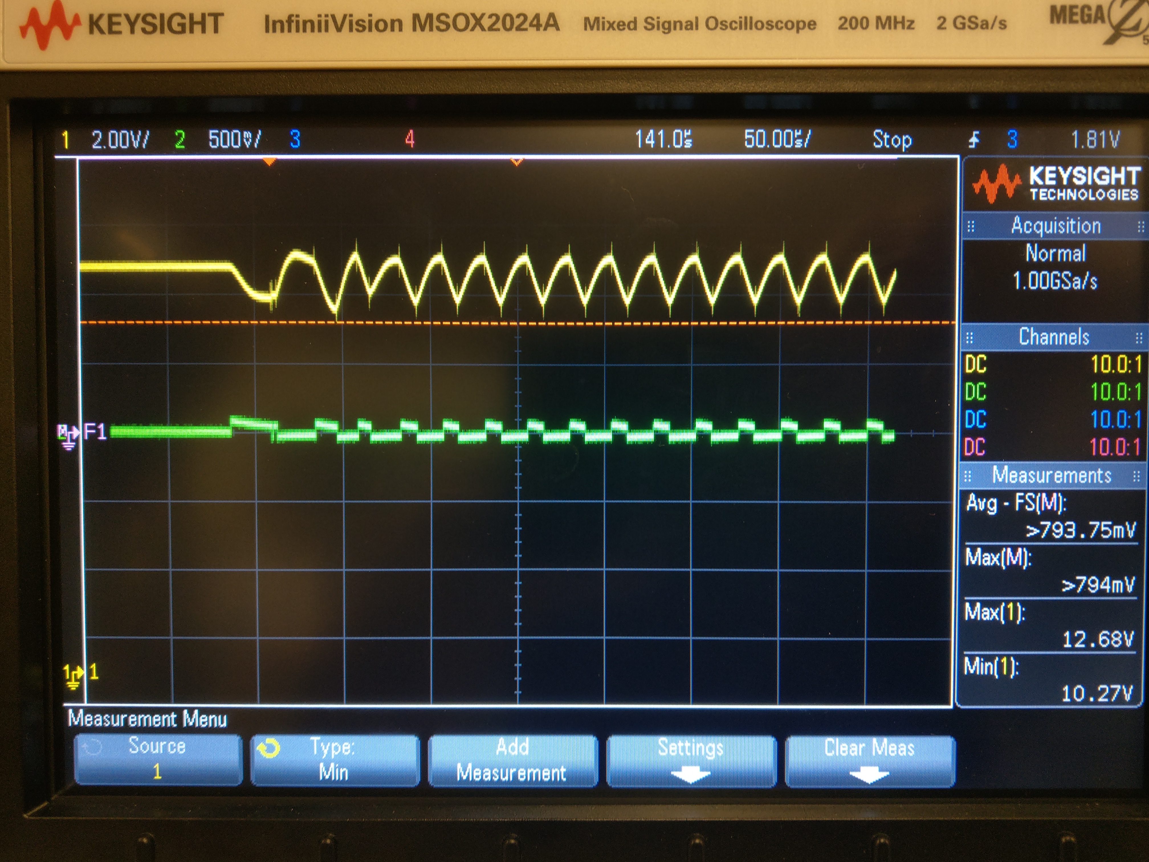

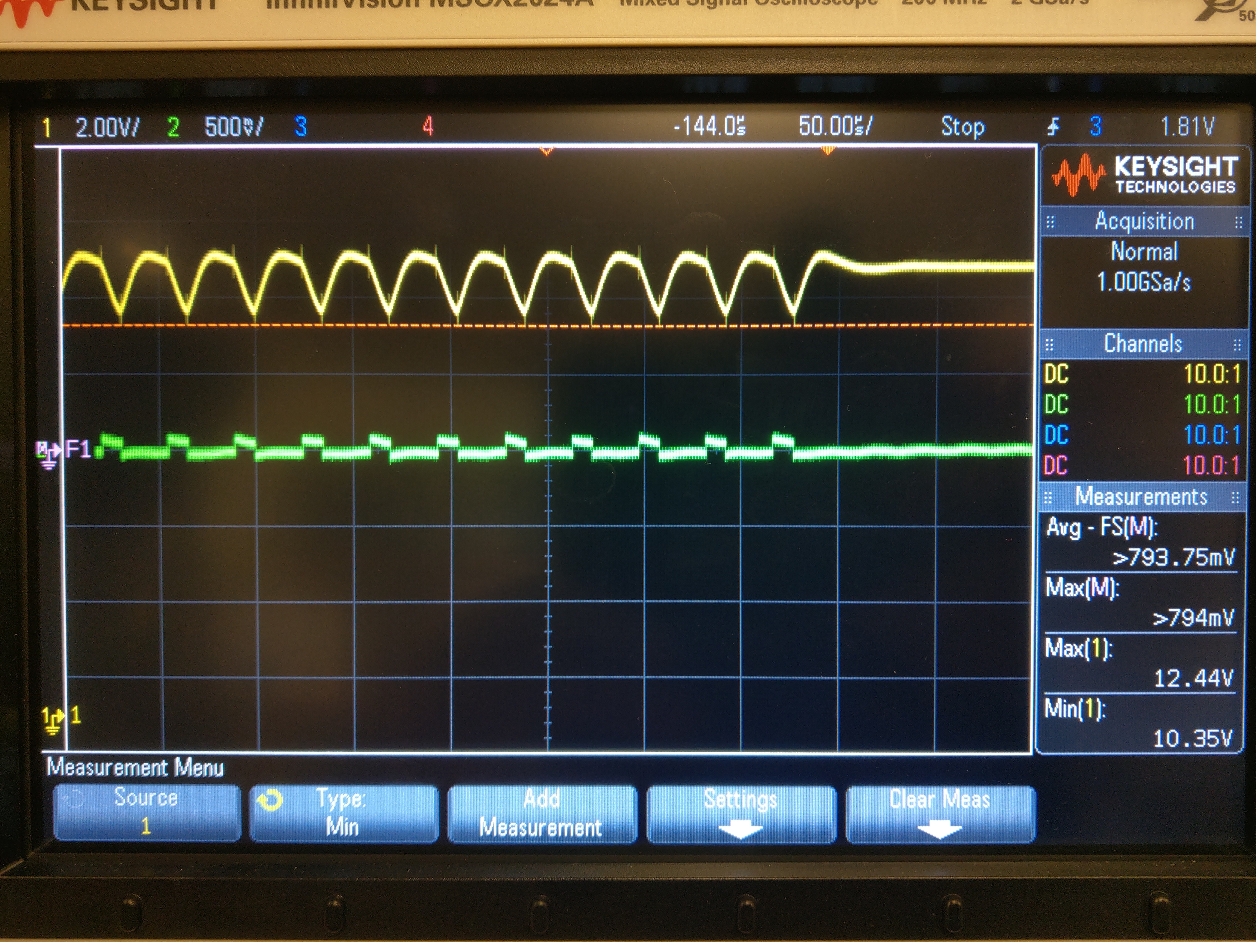

  • Here are the captures of the Vmotor supply to the driver IC
    This is stalled:
    This is a successful lift:

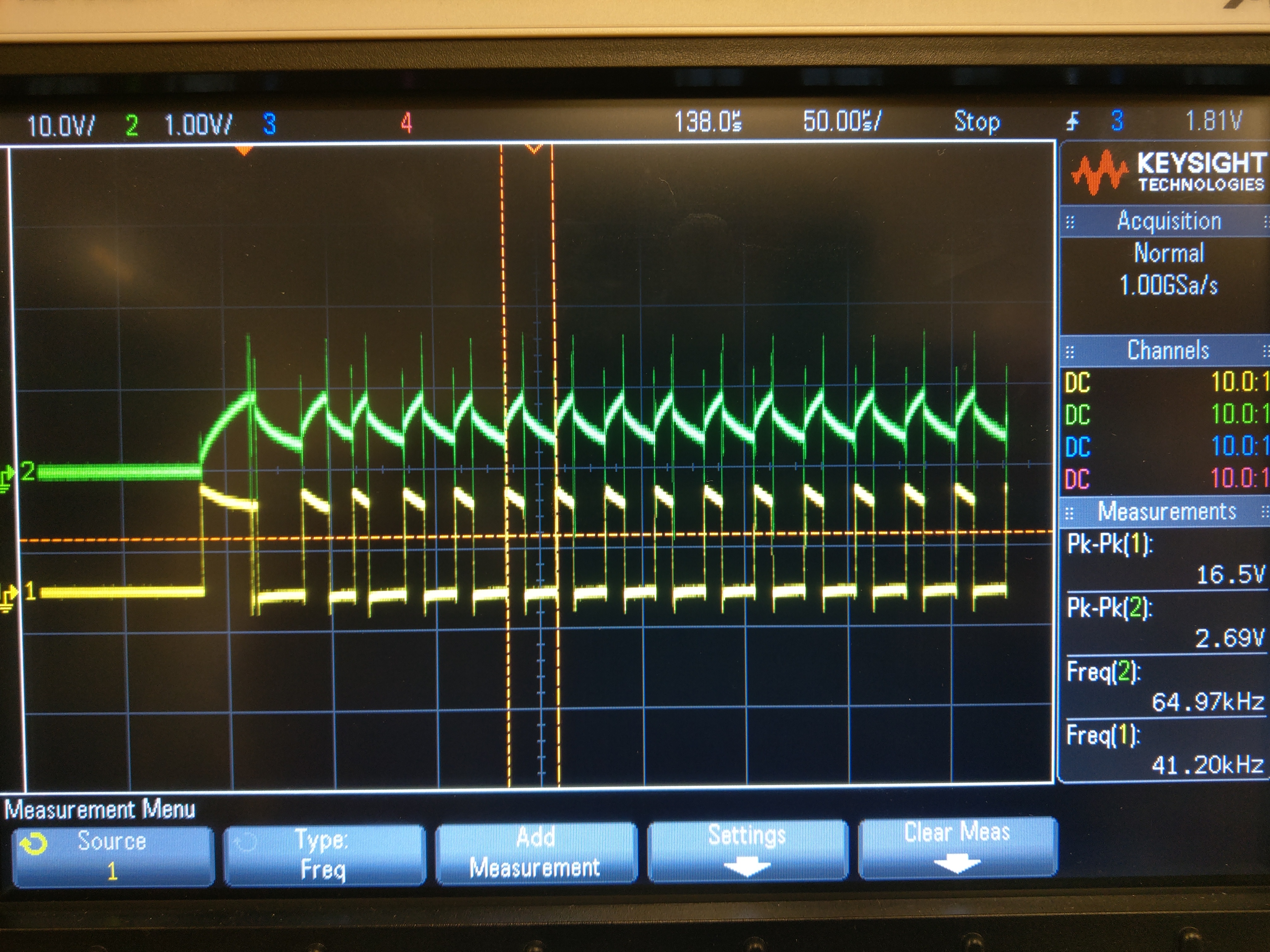

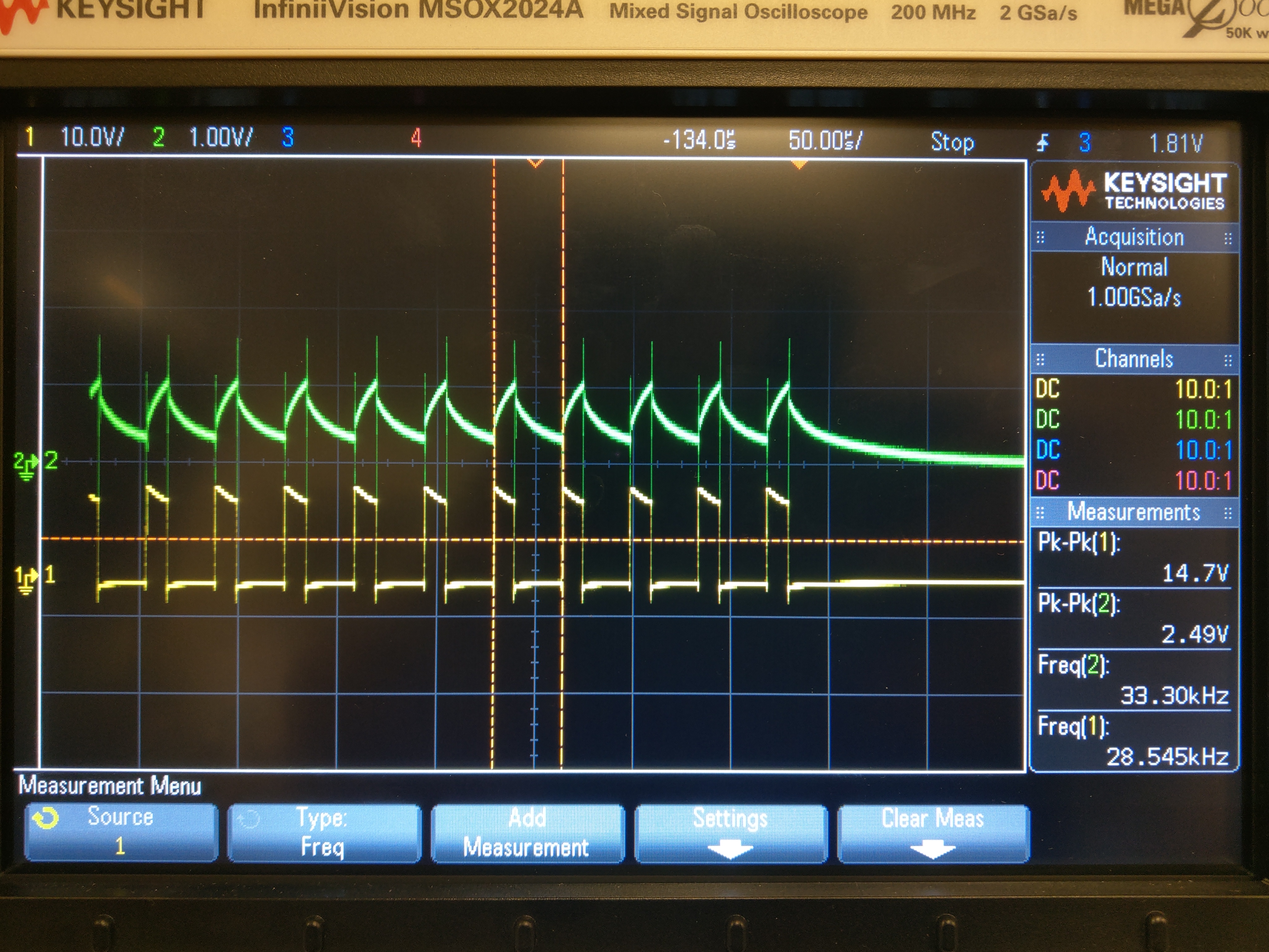

  • Here are 2 captures of the OUT1 and OUT2 signals. Green is Out 1, Yellow is Out2 on both captures.
    This is Stalled:
    This is lifting:
  • The current calculations are not accurate I think because of our shunt resistor. But still I believe less current is going to the motor at 100% PWM, as it cannot overcome the stall torque.

  • Hi Mike,
    Thanks for taking the scope shots. I agree with you that the current calculations are likely not accurate. This device cannot handle 12 A, and it may not be able to handle 5 A for extended periods of time. The overcurrent protection on this device would kick in between 3.7 A and 6.4 A.
    Based on the scope shots you shared of OUT1 and OUT2, I think the average current of the 99% case is higher. When you run at 100% duty cycle, you can see the device's fixed off time of 25 us for current regulation. When you run at the 99% duty cycle, your PWM control signal is offset from the DRV8871's current regulation timing. In the 99% case, your off time is less than 25 us. From the scope shots of the OUTx pins, it looks like the PWM pulse off time interrupts the current regulation timing, which gives you a larger average current. The 99% scope shot shows the device switching more frequently than the 100% scope shot.
    I think your motor might have low inductance which is causing you to have large ripples in the current. The large ripple is causing your average torque to be lower. I think the fix would be to find a way to have a lower current ripple or larger average current. Here are some suggestions:
