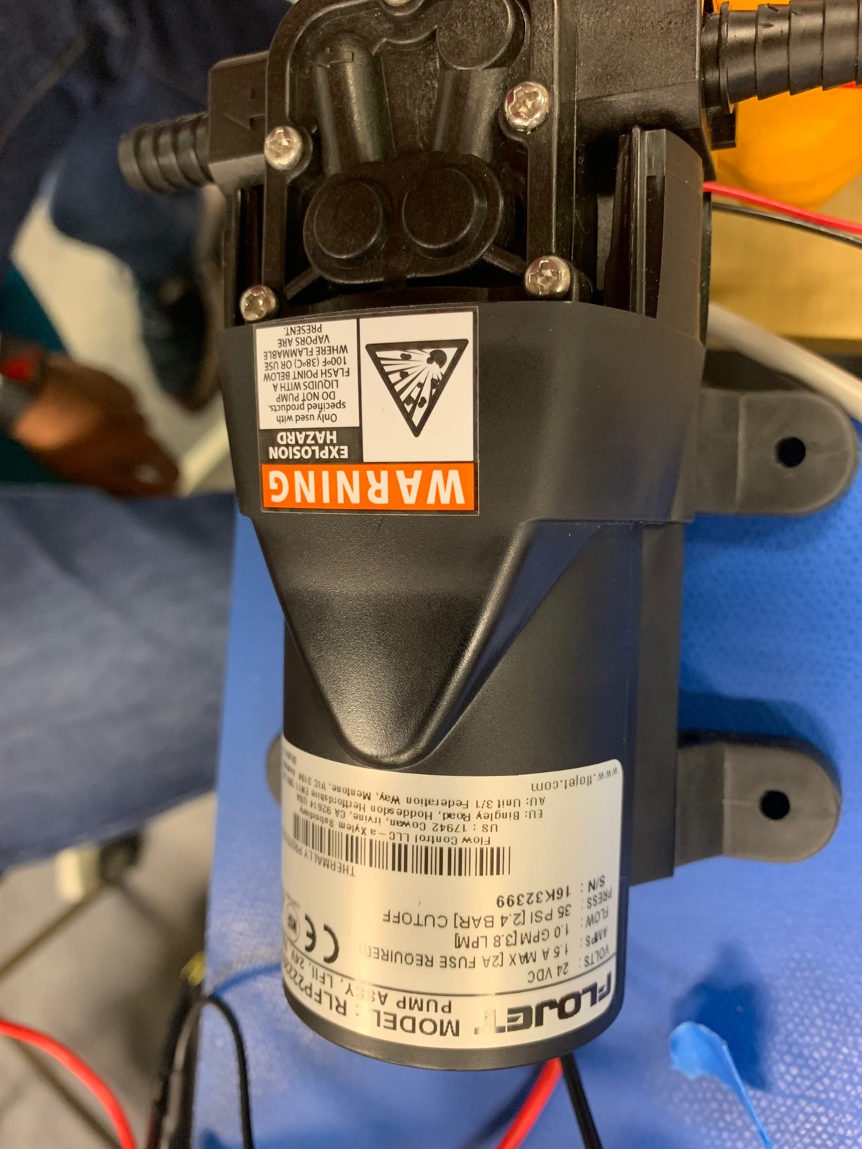

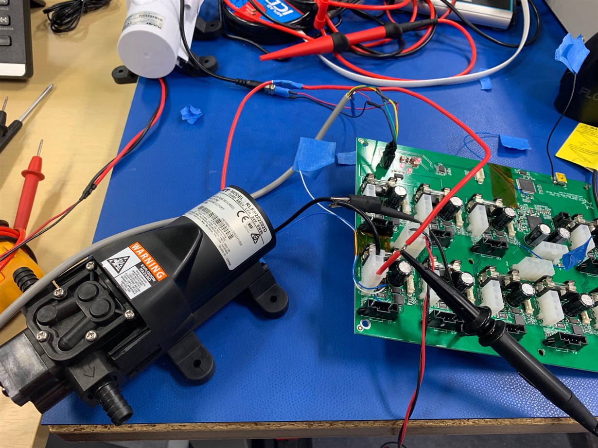

We are using the DRV8870 to drive a simple 24V DC Brush Motor.  Actually we are using it in 9 places on one board.

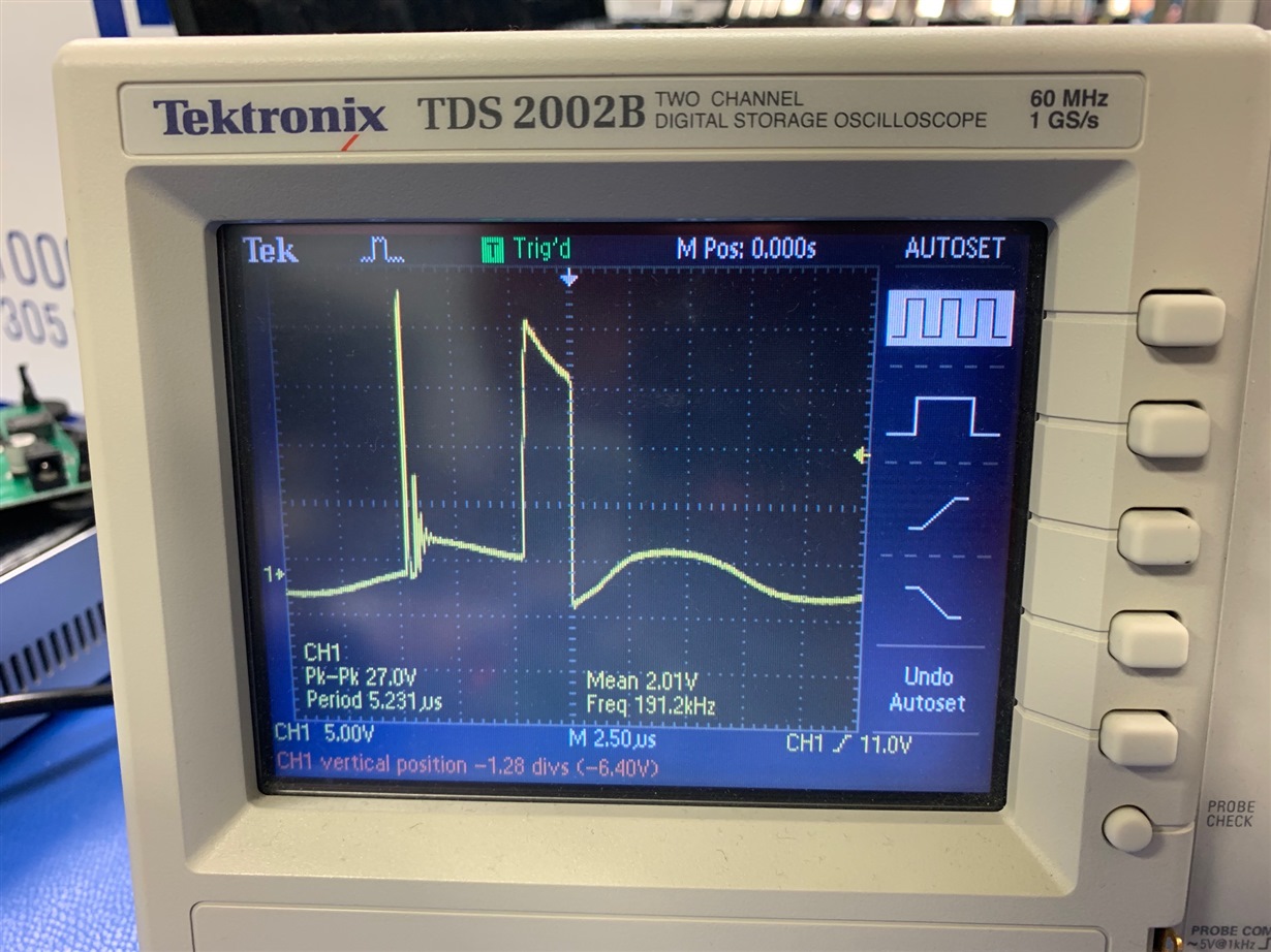

We are verifying the 90% dutycycle PWM being applied to IN2 with our Oscilloscope.  I have attached a picture showing this.
I have also attached a picture of the Oscilloscope showing the wave form when connected directly across the motor.
We increased the bulk capacitance from 68uF to 1000uF.  No improvements.  We increased it further to 2000uF, still no improvements.

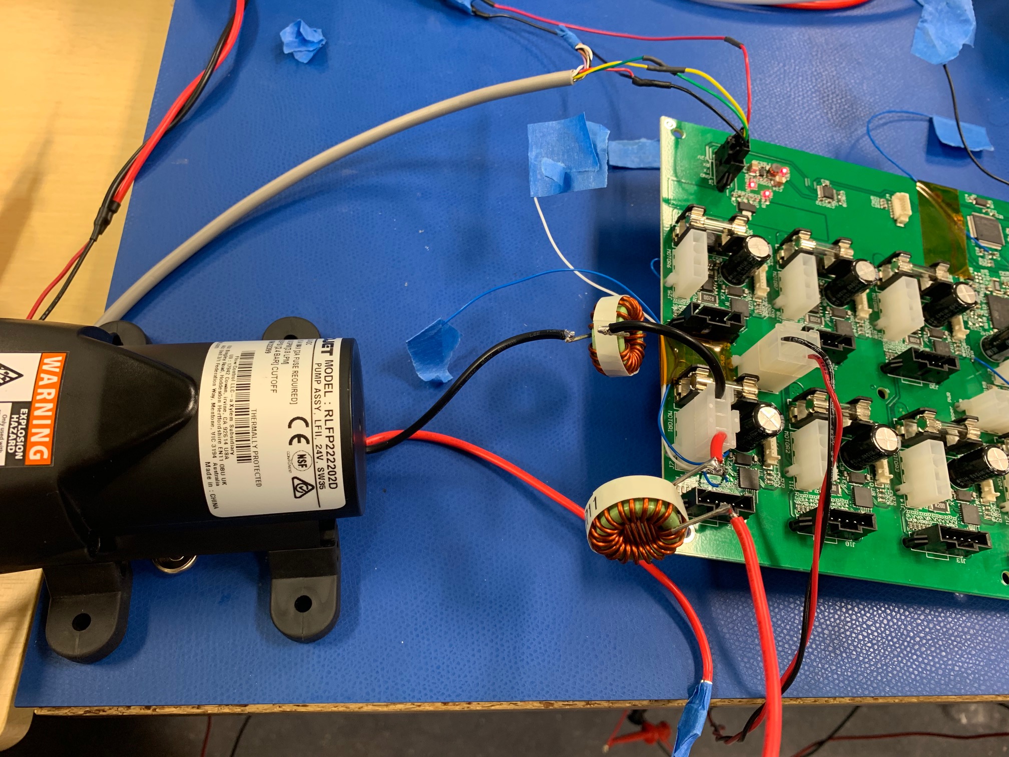

We added 2 large 22uH toroid inductors on the two motor leads still no improvement.

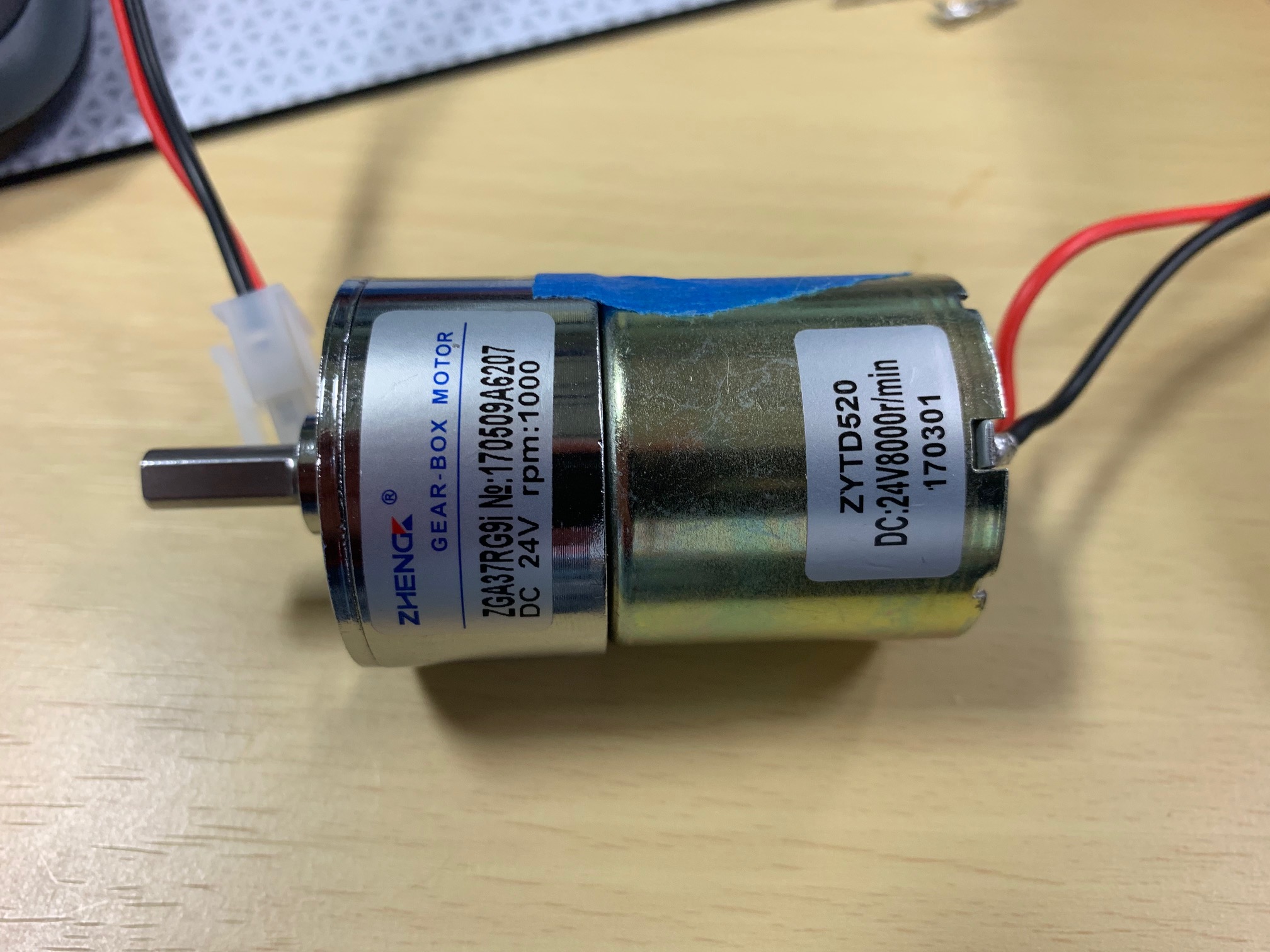

See attached picture showing the inductors in place.  I have also done this same testing with one other simple gear motor.  Same results.

    I would think the output current triggers OCP according to your description and waveform:
    1. The "connected directly across the motor" waveform shows the voltage drop very quick. That indicates the motor inductance is not higher enough which may not hold the winding current below the OCP threshold.
    2. The "connected directly across the motor" waveform shows the pulse is about 2us. That is similar as the tocp deglitch timing.
    If 24V is directly added to the motor when motor stops, there is no EMF against the input voltage and reduce the winding current. So, the OCP can be triggered. After motor spins, the EMF can reduce the winding current ramp up and avoid OCP.
    50% duty cycle can start normally. That tells us OCP may not be triggered if the winding inductance is doubled. And also tell us the 22uH series inductor could be much less than the motor inductance. That 22uH inductor can take much higher current than 1A. So, you can reduce the inductor current rating and put more wire turns to increase the inductance value to motor inductance level. So, we may avoid the OCP issue and verify the concept.

    We put QTY 2, 22uH inductors in series on each side of the motor.  You can see the picture below.
    Now we have 44uH on both sides.  The motor is operating as expected.   I can start the motor from 0 to 100% without any problems now.

    2. According to motor picture, the winding current rating is only 1.5A. The inductor size could be much smaller than what you have now.

    1. The motor cannot generate enough torque at DRV8870 OCP current level.  This is not the case, the motor 1.5A maximum rating current is lower than DRV8870 3.7A OCP threshold.
