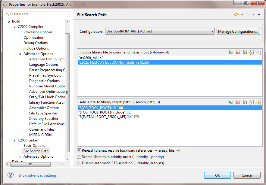

    Did you include Flash2802x_API_Library.h & Flash2802x_API_Config.h header files in your project? Is the right device (F28027) selected in Flash2802x_API_Config.h?
    Below documents explains how to integrate Flash API algorithm into your project. Please use this document as reference.
    <C2000Ware>\libraries\flash_api\f2802x\docs\Flash2802x_API_Quickstart.pdf

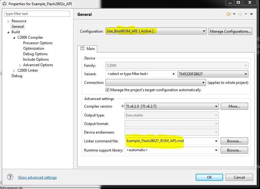

    Did you include Flash2802x_API_Library.h & Flash2802x_API_Config.h header files in your project?  Yes I did
    Is the right device (F28027) selected in Flash2802x_API_Config.h? Yes it is
    but i think the problem is F28027.cmd i am not familiar with these kind of codes !
    and in Example_Flash28027.c the linker file is Example_Flash28027_ROM_API.cmd
    in addition it is active ROM ! which proj_lab03a is Active flash .I got confuse :(  .
    i think  in proj_lab03.c ,the linker (F28027.cmd) needs to be modified ? is that right ?
    Please help me to modify proj_lab03.c (F28027.cmd)linker because the compiler can not find the location of API functions  .

    I don't think this linker command file issue. Did you include the right Flash API symbol library in your project. If you don't it doesn't recognize Flash API functions you are trying to call. Also, are you including the Flash API header files in C files which calls Flash API functions?
    Are you trying to use Flash API stored in BOOTROM? IF so, you need to include symbol library "2802x_FlashAPI_BootROMSymbols_v2.01.lib" in your project.
    As mentioned in my previous post, please refer below document which provides a step-by-step guidance on how to use Flash API functions in your project.
