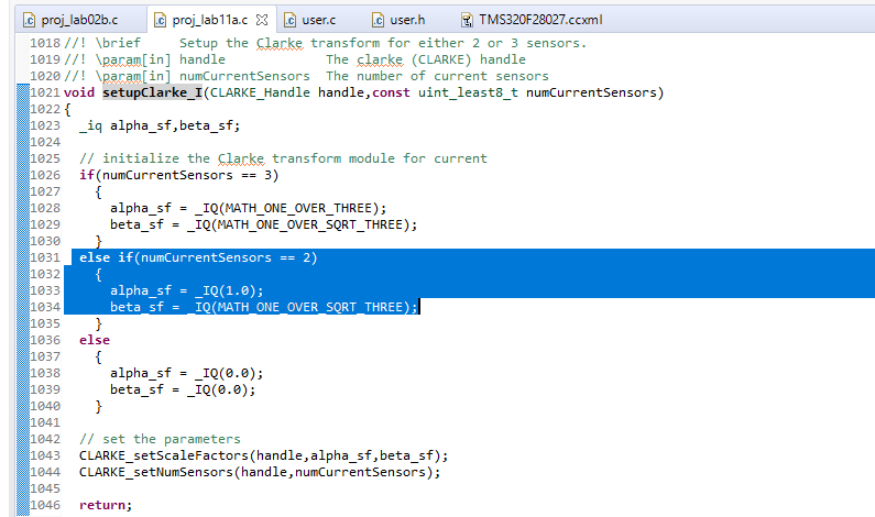

  • Hi Sean,
    I was thinking that I am changing the number of current sensors in user.h from 3 to 2, this value goes into the setupClarke_I . After that:
    TI works out coefficients for CLARKE and sets the number of sensors to 2.
    I assumed that by magic TI is calculating the third current from the first two.
    Is not this the case?
    Please hint where to look for the variable responsible for the 3rd phase current.
    Edward.
  • OK, that is correct. You should only need to change current sensors from 3 to 2 in user.h file and recompile. If there is some issue otherwise, I believe there is some other problem. Have you tried diagnosing any issues with your hardware board using labs 1b and 1c?
    Sean
