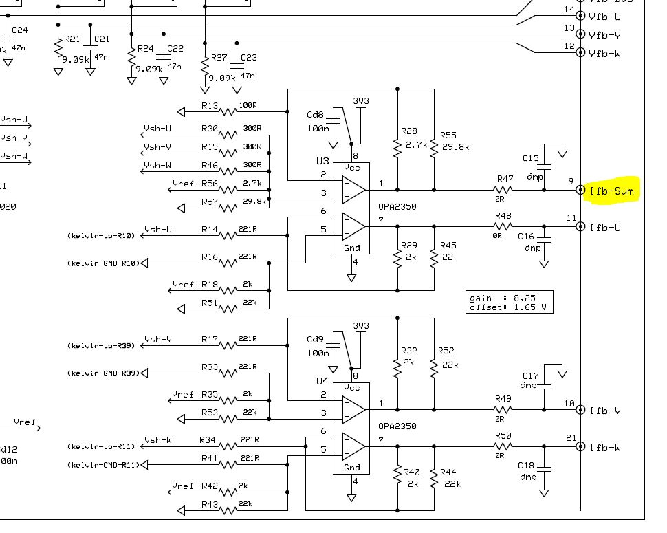

    1.my question is simple ,and  that is would it be possible to get DC current bus from any variable (sort of like VDC bus which is in gMotorvar) if so,which one?
    2. the other way would be to get it from Ifb_Sum (and write my own code for it),is that right ?
    Thanks for attention .
    Dave.
  • Dear ,
    Happy new year!
    I think I realized about
    TotalCurrent =sqrt((gMotorVars.Id_A*gMotorVars.Id_A)+(gMotorVars.Iq_A*gMotorVars.Iq_A));
    take a look at this picture which has 2 leg shunt resistor .
    Ia,Ib,Ic is the value of the current when PWM is ON which turned in to Id and Iq
    in short, TotalCurrent  is the amount of current which pass from IGBT/Mosfet Module when PWM is ON .Is that right?
    in addition ,this current TotalCurrent =sqrt((gMotorVars.Id_A*gMotorVars.Id_A)+(gMotorVars.Iq_A*gMotorVars.Iq_A));
    is  like a pulse and depends on PWM carrier freq (15khz)  we can not say this is the DC Current bus .am I right?
    I would be happy if you answer these 2 questions .
    Thanks for attention.
    Regards.
    Dave.
  • 1. In this case, using the shunt resistor on the low side, the current is sampling during the MOSFETs of the low side are ON, but all high side MOSFETs are OFF. The TotalCurrent you mentioned is the vector current from FOC side, not real current on h/w board or motor lines.
    2. The current is a sinusoidal shape and is sampled using a shunt resistor on the low side, not dc-bus current, it's totally differenet.
    You might have a look at Chapter 17 of instaSPIN user's guide (SPRUHJ1G ) which has a detailed description of this.
