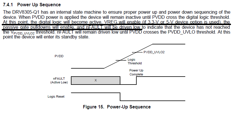

My customer is evaluating DRV83055QQ(Integrated 5V LDO) version.
Now, they are asking about the Power-Up Sequnce definition.
1. Figure 15 shows the definition. PVDD_UVLO2 is defined min. 4.4V/max. 4.7V @ rising.
    How about the Logic Threshold? Digital I/O VIH = min. 2V/max. 5V?
2. Thecustomer is connected with 5V MCU via SPI. I think internal logic is operating with
    3.3V. Is it no problmem to connect DRV83055QQ with 5V MCU? It has 5V tolerant?
Sorry again & again, but please give your advice.
H. Sakai

  • Dear, Anuj-san.
    My question about VREG has been cleared. Thank you so much for your teaching.

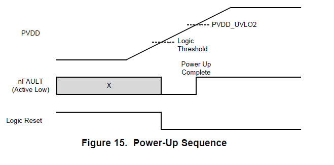

    The other side, "Logic Threshold" on Figure 15, Power-Up Sequence is still not cleared.
    Please give your advice on this remaining question.
    H. Sakai
  • Hi Sakai-San,
    The logic threshold indicates that the DVDD voltage regulator has reached its nominal voltage (nominal voltage =3.3V but can be active at a slightly lower voltage)
  • Hi Sakai-San,
    Do you have any additional questions or is this resolved ?
  • Dear, Anuj-san.
    Thank you so much for your detail explanation.
    The Logic Threshold is defined based on PVDD. According your explanation,
    The PVDD voltage would be DVDD nominal = 3.3V + DVDD LDO Dropout voltage.
    Is it possible to clarify the DVDD LDO Dropout voltage?
    Or Internal VREG become operational at PVDD = 4.3V. It is defined by datasheet.
    The PVDD voltage would be referred this voltage?
    You don't need to assure that, but we need a kind of criterion on the definition
    by datasheet.
    PS)
    the customer is used DRV83055Q(internal 5V VREG version).
    H. Sakai
  • Hi Sakai-San,
    a) for internal 5V VREG version, the condition for SPI communication is PVDD > PVDD_UVLO2 . There is no dependence on DVDD
    b) for external VREF version , the condition for SPI communication is PVDD> ~3.3V
    Since the customer is using (a) the DVDD voltage and DVDD LDO dropout does not matter. It is very small anyways.
  • Dear, Anuj-san.
    Thank you so much for your reply & information.
    Question regarding SPI has been cleared, already.
    I would like to know the PVDD voltage at "Logic Threshold" on 5V VREG version.
    The datasheet defines that digital logic will become active, VREG will enable.
    It should be over 3.3V(DVDD output) because PVDD should be over DVDD.
    I am expecting your clarification about PVDD voltage at "Logic Threshold" on 5V VREG version.
    H. Sakai
  • Hi Sakai-San,
    For 5V VREG version, Logic Threshold will be over PVDD=3.3V
    For 3.3V VREG version, Logic Threshold will be over PVDD=3.3V
  • Dear, Anuj-san.
    Thank you for your reply.
    VREG output between PVDD=4.4 to 5.3V is defined on datasheet.
    It means that VREG has started up already.
    PVDD = 4.3V is defined as VREG operational voltage on datasheet.
    I guess "VREG will enable" equal in this voltage.
    I wonder my guess is wrong?
    H. Sakai
  • Hi Sakai-San,
    Your guess is correct. VREG will only be enabled at PVDD=4.3V
