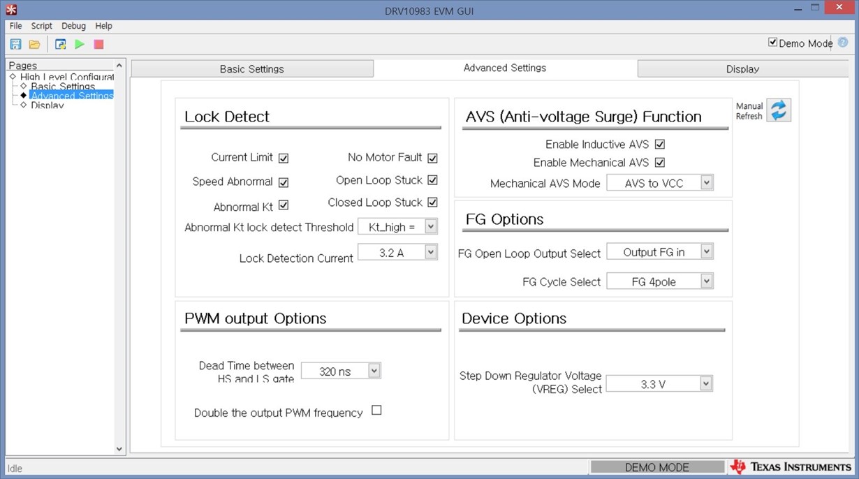

    For just initially getting the motor to spin, I would solely use the EVM and EVM GUI, not the code.
    What is the code used for? You should be able to change the EEPROM registers and send I2C commands and spin the motor through the GUI.

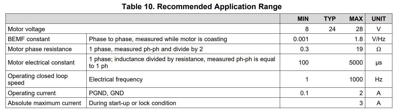

    Please make sure the motor is connected to the EVM and is within this application range. Especially if the phase resistance of the motor is greater than the range, then the DRV10983 will have a no motor fault.

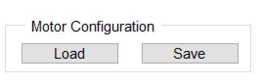

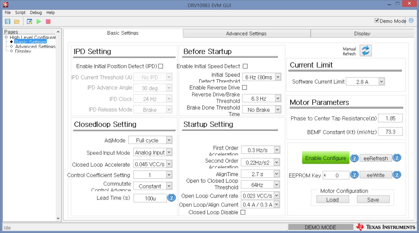

    The DRV10983EVM GUI cannot export code in your format, but if you have your desired eeprom settings in the EVM GUI, you can see the list of addresses and their values to write through I2C by using the "save" button on the "Basic Settings" page of the GUI, which will save the eeprom settings as a csv file.
    zcx.csv
    To see what actions in the GUI correspond to different commands, you can go to the "script" tab in the GUI, select "Launch new window", and then in the "script" tab, click "Start Recording". Then any actions in the GUI will be recorded with the corresponding I2C EEPROM command.

    3) Make sure the customer's motor is in the "recommended application range".
