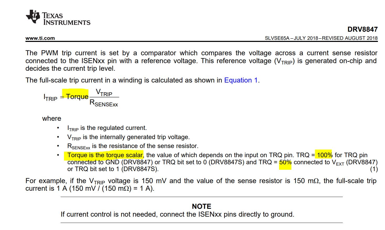

hi, All.
i've been asked by customer for below question.
please support it.
Q1
correct for below?
in case of 100% TRQ(connect to GND), should Torque be "1"
in case of 50% TRQ(connect to Vext, should Torque be "0.5"
the following sentence is confused.
"Torque is the torque scalar, the value of which depends on the input on TRQ pin. "
it sounds like that there are + polarity figure on TRQ.
there are only 2 thing on Torque such as 1 or 0.5. right ?
in case of 0.5,  we can see "0.5" but not for "1" but Torque.
Q2.
what is the Vext ?
there are nothing description about Vext.
should customer use voltage same as VM or any specification ?
Q3.
is it ok if we could make TRQ pin floating if customer doesnt use?.

    1. Yes. in case of 100% TRQ(connect to GND), should Torque be "1"; in case of 50% TRQ(connect to Vext, should Torque be "0.5".
    Yes. TQR only has two options: 0.5 or 1.
    2. Vext should be external supply for logic circuit. Page 17 note (1) has the definition. Also, you can find Vext on Figure 15, 16. It could be a pull-up source for logic circuit, nFault pin, TRQ pin.... So, the voltage range should follow the TRQ pin spec or any pin spec which uses Vext as a pull-up source.
    3. Firgure 15 shows the TRQ pin has an internal pull-down resistor. If you leave TRQ pin float, it will be low.

    does it mean that customer can make it floating . right?
  • Masaharu-san,
    Firgure 15 shows the TRQ pin has an internal pull-down resistor. If you leave TRQ pin float, it will be low. Torque be "1".
