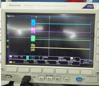

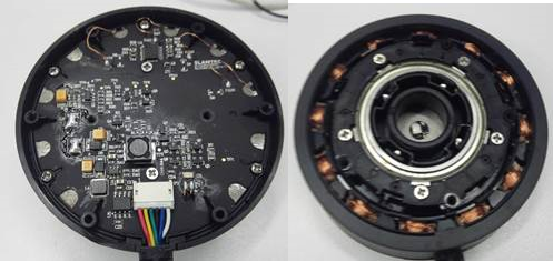

we use DRV11873 to drive the permanent magnet dc micromotor, and we add the function of wireless charging in the middle of the motor, as shown in the figure below.
1: the fault phenomenon is that the dc motor cannot work normally when the power is supplied, and there is no voltage in U/V/W, so the test waveform is shown in the figure below.
If we remove the wireless charging function, the motor will work normally. How can the magnetic field affect the normal work of DRV11873? Thank you!

  • 1:
    A) PWMIN has always existed.
    B) the failure phenomenon of pulling up to 5V on FG and RD remains the same.
    C) the RD did change from low to high. Indeed, the chip detected a fault and started the drive again after 5 seconds.
    2:
    After the PWM signal was input, the chip tried to drive the motor and applied voltage, but the motor did not move.
    In the case of no interference from the transmitting coil of wireless power supply, the chip ignored PWM signal at startup and was driven by dc, and 10 phase changes were measured. PWM signal at the 11th phase change was intervened.
    When there is a wireless transmitter coil interference, chip attempts to drive motor, can be seen when the third phase PWM signal, the signal frequency is about 60 k, our wireless power supply is also on this frequency, should be a motor coil induction power supply for wireless transmitter coil magnetic field, the chip to drive the motor when the two parties work produced interference at the same time.Tank you!
  • 1)I think it woud be useful to see where the wireless charging circuit is in relation to the motor and DRV11873. Can you send a schematic?
    2) When you say "In the case of no interference from the transmitting coil of wireless power supply, the chip ignored PWM signal at startup and was driven by dc, and 10 phase changes were measured. PWM signal at the 11th phase change was intervened.", does this mean that the motor didnt spin properly when the 11th phase change was intervened?
    3) I dont understand this: "When there is a wireless transmitter coil interference, chip attempts to drive motor, can be seen when the third phase PWM signal, the signal frequency is about 60 k, our wireless power supply is also on this frequency, should be a motor coil induction power supply for wireless transmitter coil magnetic field, the chip to drive the motor when the two parties work produced interference at the same time.Tank you!". Can you please explain a little more in full sentences?
