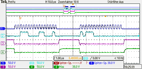

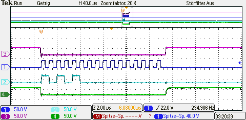

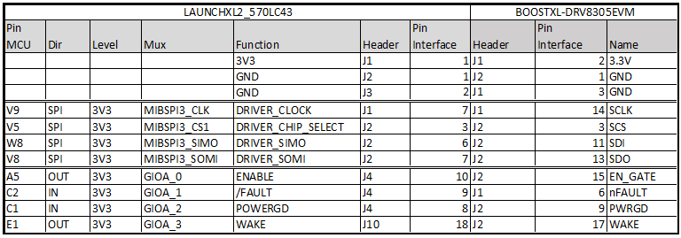

I have problems with the SPI communication. The timings were set according to data sheet. The SDO signal always goes to "zero" during transmission. Wake was set to logical 1. PVDD to 12V. See Scope. Evalboard is LAUCHXL2-570LC43.
1 = SCLK, 2 = SDI, 3 = SCS, 4 = SDI
Why do I receive no valide data?
