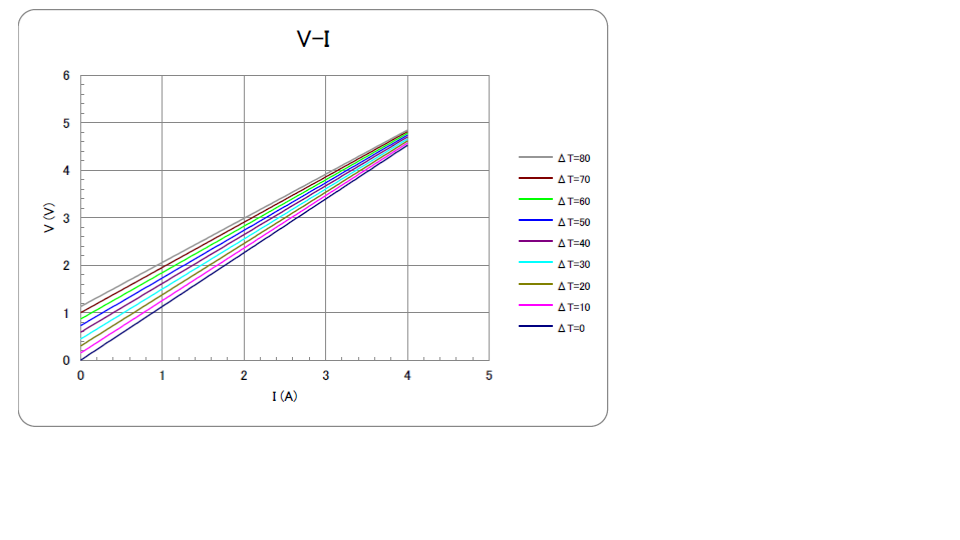

DRV8873 issue: VM power supply=6V@9.5W,  IN1/2 duty cycle setting 50%.
VOUT1/2 path add LC filter, TEC_VOUT1=5.29V, TEC_VOUT2=2.88V, IPROP status output=2A, but fault occurred.
TEC(V(V)) : Vout1-Vout2= 2.41 V(V), to check TEC current about 1.5-2.2A, as attached file .calculator TEC power loss around 3.62-5.3W.
but VM power is 9.5W, IC isn't hot, May we know how to calculater power loss? (we main concern is if TEC consume is 5W, then it is mean IC will having 4W power loss,is it normal in this kind application?)

    when we connect TEC, then fault pin will be high, but we still can control DRV8873.
    For TEC feature,when flow current more high, TEC impendence will reduce.
    For last question, we still check power calculation issue. and why fault pin on when we connected TEC.
