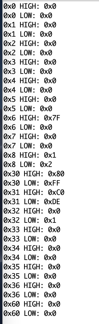

Hi there,

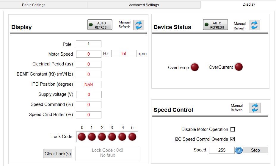

I have been trying to drive a bldc motor with the drv10983Q1 chip for the past couple days with no success. I have been successfully able to communicate with the device over I2C, and I have set the required registers as specified in the datasheet. I set the speed control register but the motor does not move and the MotorSpeed register reads 0x00. Here is a picture of the read register values. I am not sure what I have done wrong.
I am using 24V supply (which I have measured and is correct) and the current I am drawing is what approximately what is expected according to the datasheet.
Any help would be greatly appreciated :D

    2) In your I2C commands image you gave, can you tell me what the "High" and "Low" means? Also are all those writes? If you answer these questions, then I will be able to read your I2C commands a little better.

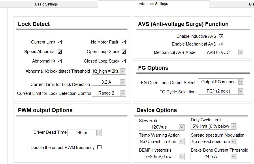

    4) The motor wont spin if it goes into lock. Check if it goes into lock by checking the following CONFIG5 Register (address = 0x94). There is a tuning guide for configuring the device to spin your motor properly so no lock condition occurs (www.ti.com/.../slvuav9.pdf).

  • By high I meant bits 15-8, and low = bits 7-0. The override bit is set to 1 and the motor is not in lock. I cannot send you a picture of the scope output because the chip is not outputting anything from pins U, V, or W (even though the speed is set).

    1) Easiest thing to do is when you try to run the motor, please read all of the registers and send them to me, so I can see what potentially is going on.
    2) Right now, the speedctrl is set very low (0x11 or 17/511 = 3% duty cycle). Please try setting the speedctrl to max = 0x81FF or 511.
    3) Sometimes, disabling, then enabling again the Override bit will refresh the device speedctrl.
    4) See whats in the speedcmd and spdcmdBuffer registers.

    Here are the register values. I'm setting the speed to 0xFF, but the motor does nothing, the SpeedCmd value is changing, but nothing is being output on any of the phases.
    Config register values
    I am able to successfully read and write eeprom values, the only strange behaviour I have encountered is that the SupplyVoltage register (0x05 LOW) is 0x00 even though the VCC is at 24V.

  • 1) The following behavior is abnormal:
     a) The supply voltage register reads 0x00, even though Vcc is applied.
     b) although the speedctrl is set = 50% (FF) and the speedcmd also shows 50% (7F), the actual speed and motor speed registers indicate zero speed and the speedcmdBuf = 0 as well.
    Can we make sure the device isn't damaged?

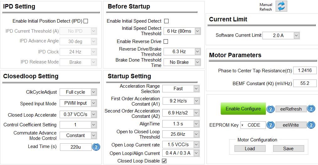

    2) Regarding your question on whether there is any example code to get the motor spinning in open loop, I can confirm that your eeprom write commands you set should get the motor spinning, but you need to set CLoopDis = 1. So the EEPROM Writes to the config registers should be like below:
    GUI.write_register("DRV10983Q1","CONFIG1",0x48)
    GUI.write_register("DRV10983Q1","CONFIG2",0x2F3B)
    GUI.write_register("DRV10983Q1","CONFIG3",0x50)
    GUI.write_register("DRV10983Q1","CONFIG4",0x1B8A)
    GUI.write_register("DRV10983Q1","CONFIG5",0x3FAF)
    GUI.write_register("DRV10983Q1","CONFIG6",0xBCC3)
    GUI.write_register("DRV10983Q1","CONFIG7",0x16A)
    GUI.write_register("DRV10983Q1","SpeedCtrl",0x80FF)
    To visualize your settings, they are below:

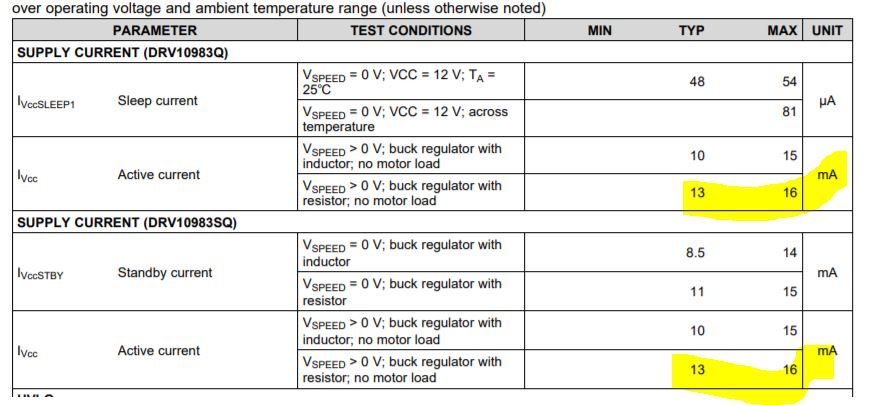

    As far as answering your questions, I don't think the chip is damaged as I tried a new chip and had the same issues. The chip is drawing approximately 20mA at 24v, yet the supply voltage register indicates 0x00 so I'm not sure what the issue is there.

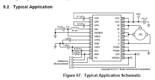

  • That Icc of 20mA is greater than the electrical spec max. It may be because of inaccuracies in measuring Icc. but that's just something to keep in mind, I would recommend just checking Vreg, V3P3. and V1P8 as well just to make sure everything is working fine. It could be that the board you are using has some problem, and that is why when you switch in different chips, they all fail. It's just a suggestion.
    Also make sure you are using the typical application schematic below as in the datasheet:

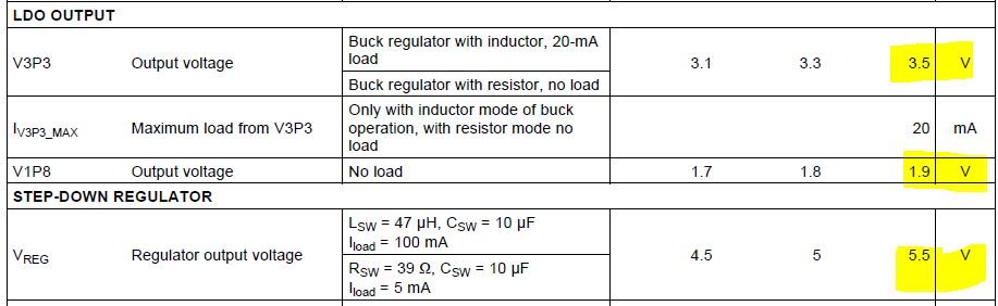

  • alright I got a value of V1P8 = 2.1V, V3P3 = 3.9V, and VREG = 5.7V. Is there something other than the board design that might be causing this to happen?
  • 1) Those voltages are above the maximum values in the electrical spec as shown below.
    This can be because of improper measuring equipment or something wrong in the schematic, maybe particularly the external components related to the Vreg and SW pin.

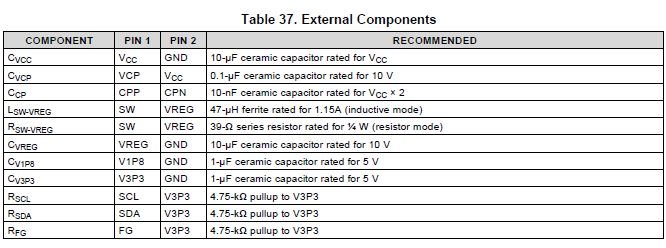

    As mentioned before, follow the recommended application circuit. Also follow the recommended components table below.
    2) If you are still having trouble with that board, we have reference boards you can build or use as reference.
    Find "hardware design files" on this page ( http://www.ti.com/tool/DRV10983Q1EVM
  • Ya, my design is identical to the reference design, so I'm at a loss, but I'll triple check the pcb to see if there's something I missed
  • I have rechecked my pcb and it is not possible that the pcb is causing the issues I am encountering, my design is identical to the reference design, and I have remeasured the values at V3P3, V1P8, and VREG and they are within the maximum allowable values. All register values seem fine, except the supply voltage register is reading zero and I am not getting any output. I am not sure what to do next as I have followed every step of the datasheet and the chip is not working as it should be
