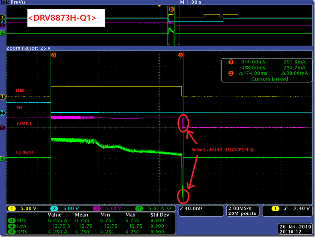

Hi
NFAULT of DRV8873 is output at the motor stop point (Brake timing).
This causes the motor not to stop at the stopping point.
* Waveform 1: DRV8873H-Q1 - Brake released due to OCP occurrence at Brake
Measuring conditions
- DRIVER IC: DRV8873H-Q1
- DRV8873 Control signal
- DRV8873 制御信号
  #1 (GND): 0V
  #2 (3.3V): 3.3V
  #3 (nFault): --> Ch3
  #4 (MODE): 0V
  #5 (SDI/SR): 0V
  #6 (SCLK/nITROP): 0V
  #7 (nOL): 3.3V
  #8 (EN/IN1): --> Ch1
  #9 (PH/IN2): --> Ch2
  #10 (DISABLE): 0V
  #11 (IPROPI1): 0V
  #12 (nSLEEP): 3.3V
  #13 (IPROPI2): 0V
  #14 (GND): 0V

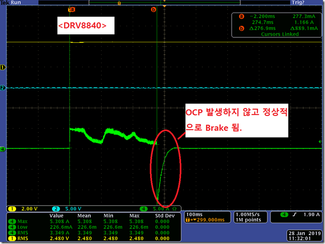

* Waveform 2: DRV8840 is normally braked without OCP. (V_REF 2.48V)

  • Hi Andy,
    The 12A shown in the DRV8873 is greater than the OCP threshold, and causes the device to disable the outputs.
    Instead enabling the brake at 100%, please try lowering the duty cycle for a short time (10ms?) and then brake at 100%.
    The goal is to minimize the current spike when braking at 100% to less than 10A. Ideally if you can lower the current further, this should minimize the chance of an overtemperature event disabling the outputs.
