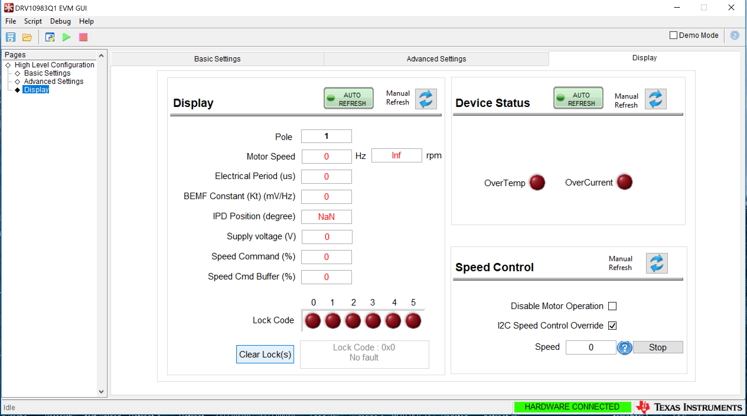

Hi there, I purchased the DRV10983Q1 EVM and after looking at the display tab of the GUI, the values seem to be incorrect (for example its displaying the supply voltage as 0V even though I measured it at the supply pin as 24V). I am unable to upload to the EEPROM, I just get an error saying that the EEPROM is not ready. After looking at the I2C SDA pin I can see that I am sending commands but not receiving anything back from the DRV10983-Q1.
I also tried just setting a speed without anything connected and I get an overcurrent fault. Not too sure what the issue is.

    4) I think in your previous issue as well, you saw supply voltage register show 0V. This is concerning. Can you send me screen shots of the GUI pages you have? Im going to order a new EVM for myself to verify if there are any problems with the devices on the EVMs recently.

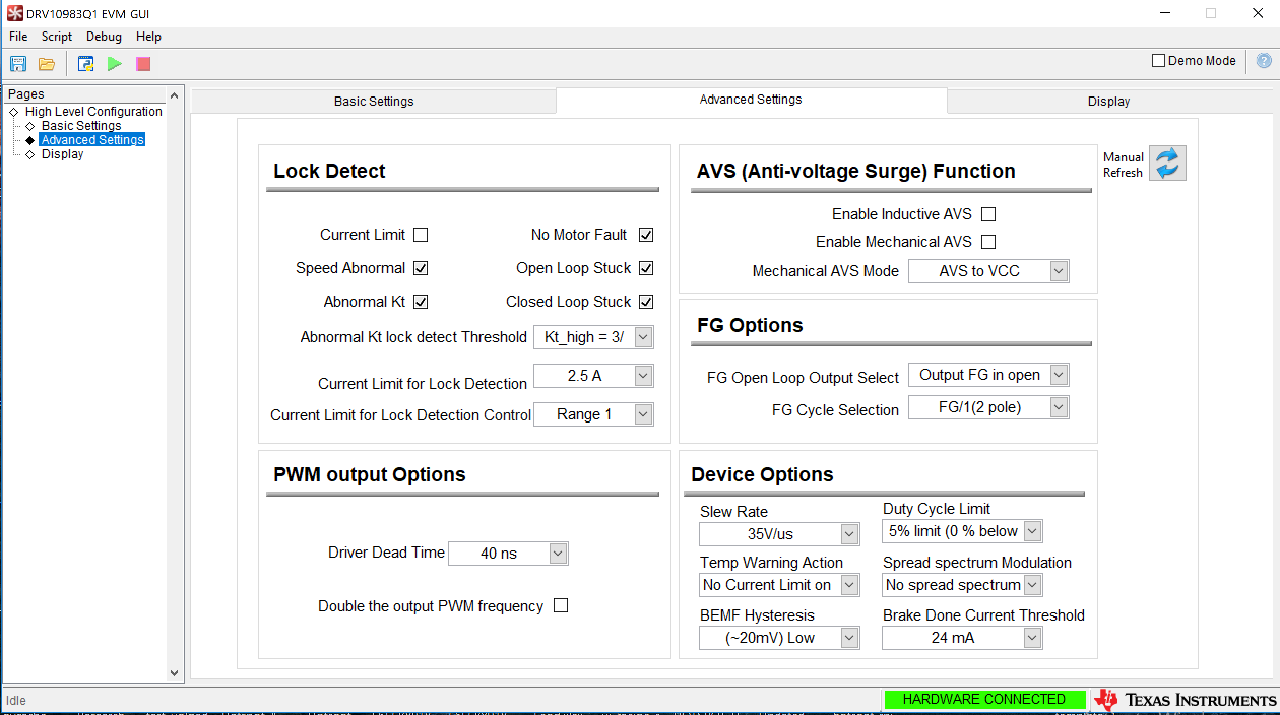

  • 1) Change the dead time to 1.08 µs. This might be the thing causing overcurrent. This might also correlate to the voltage register not reading properly. Always follow Table 3. Dead-Time Settings recommendations from DRV10983-q1 tuning guide
    Meanwhile I'll be checking a DRV10983-q1 unit on my end to see what might be the problem.

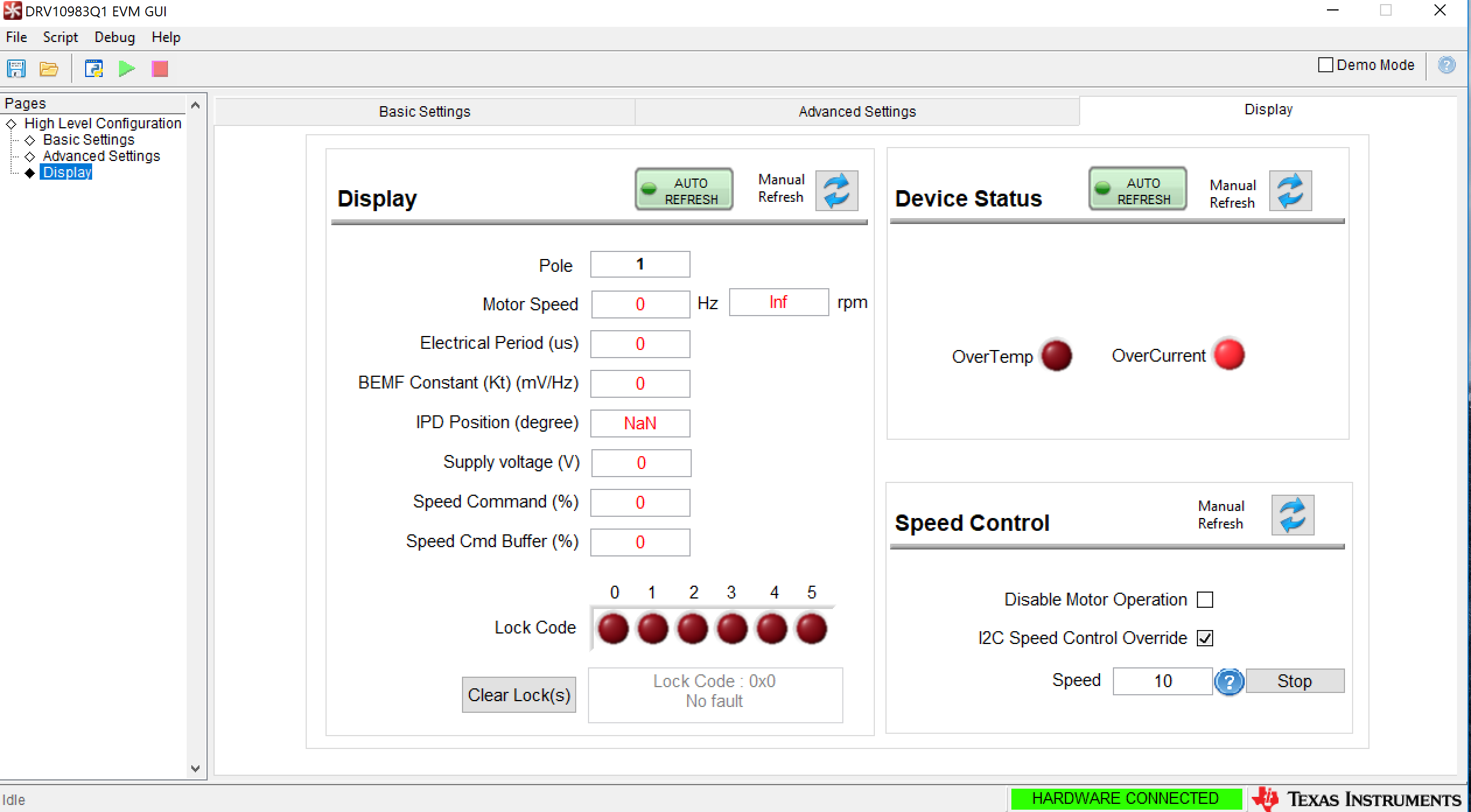

  • ok so I changed the dead time to 1.08us which solved the over current issue. But Im still getting the same values in the display tab (I tried both setting autorefresh and manually refreshing). I have tried hooking up the brushless dc motor (www.faulhaber.com/.../  ) , when I set the speed to anything less than 10, nothing happens, and any speed I set at 10 or above it seems to move at a fixed speed (fairly slow) no matter what speed I set it at. It also draws around 25mA - 32mA no matter what speed I set it at above or equal to 10.

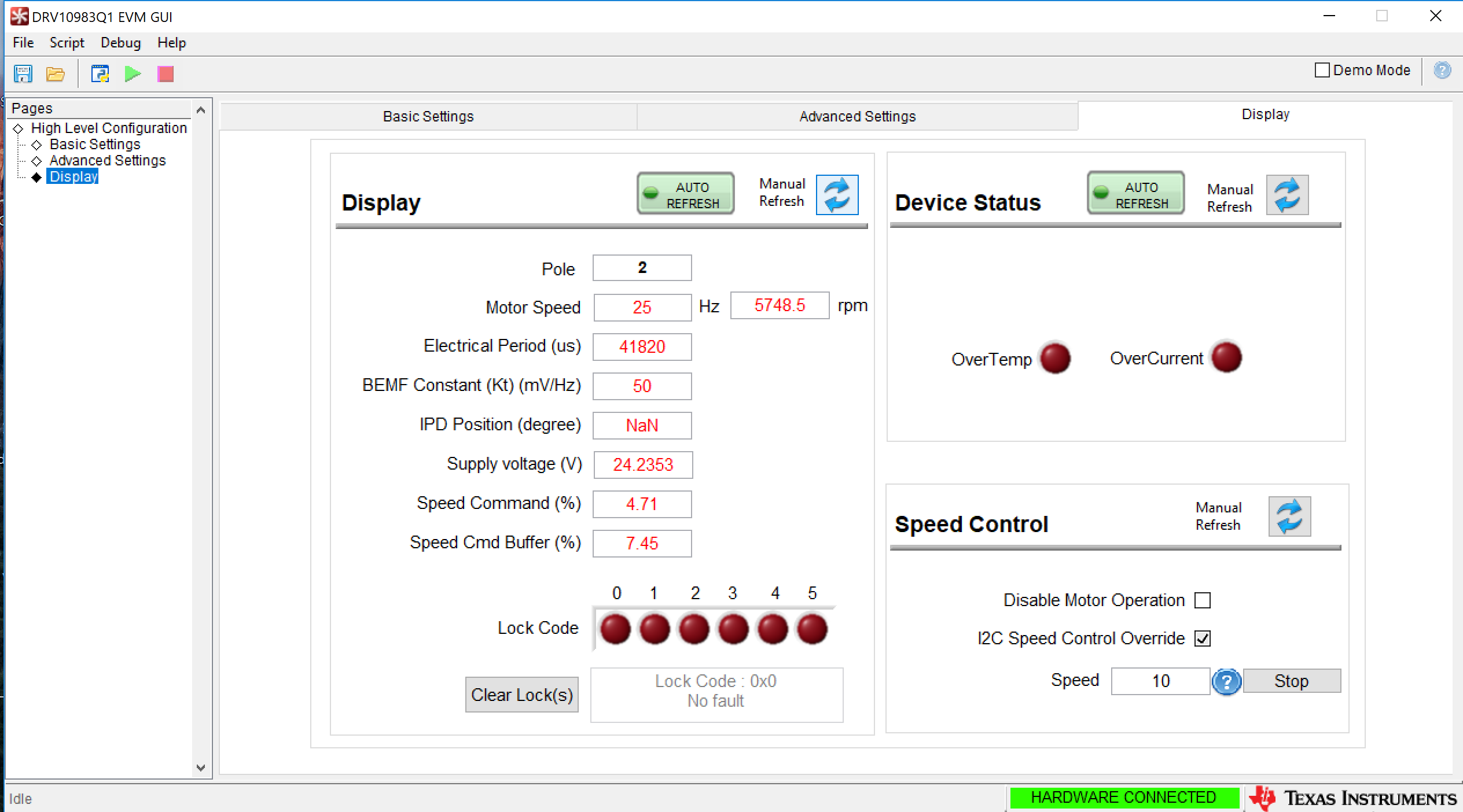

  • So after varying some of the parameters I am able to get the motor spinning and displaying values, however setting the speed to anything below 10, the motor doesnt move. And anything 10 or above, the motor stays at a constant 25 hz
  • Is the motor driver unable to drive a motor less than 5.6Hz?

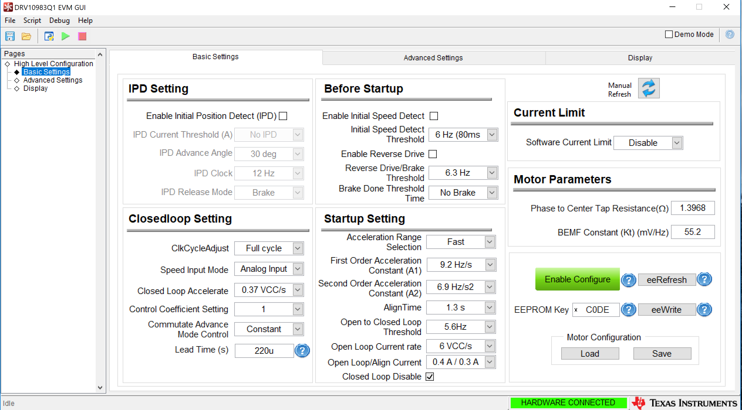

  • 1) Our sensorless driver cannot spin motors at very low speeds in closed loop. The exact cutoff speed really depends on the motor and you would need to experiment to find it out.
    2) If you are trying to spin low speed at open loop, it really depends on the amount of load torque. But you can try to increase the open loop/align current to get more control to spin at lower speeds in open loop.
    2) The value you put in the "Speed" box is the duty cycle level out of 511. So entering a 10 is the same as saying apply a duty cycle % of 10/511 or 2%, which is very small. So please enter faster speeds.
    3) Because you have closed loop disabled, you cant control the speed once it reaches the open to closed loop threshold, as it will stay at that speed. Disable closed loop.
    4) Usually a good handoff speed is around 25Hz to enter closed loop. Are you able to enter closed loop?
