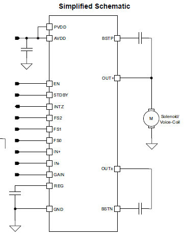

is it possible to use this driver in half-bridge mode? This could save money on discrete components.
Configuration could look such as this schematic. Connecting actuator on OUT+ and leave OUT- unconnected.
This means IN- would be VCC3/2 and IN+ will be driven with a variable voltage from 0..VCC3.
Is this a possible configuration?
What would be the maximum duty cycle? Is a 100% (or 0%) duty cycle possible with DRV2511?
Is open connection of OUT- possible? Any protection or diagnostic issues?
This all would save additional discrete components such as cap, filter and snubber.
Many Thanks
Josef

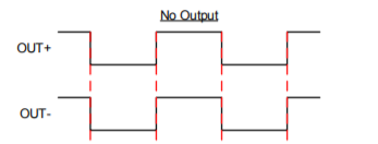

    Usually, we don't recommend to use the devices with BD modulation in a half-bridge mode. I will explain some consequences so customer could consider if he still want to use it or not.
    - In BD modulation, the output pins are both in phase when there's no input.This means that if the device is used only with OUT+ or OUT-, the load will be active when there's no input.
    - Customer would need to use an inverse logic to handle the load. As stated in the datasheet, when there's a positive differential input, the OUT+ duty cycle is greater than 50% and the duty cycle of OUT- is lower than 50%. So, customer could choose between the OUT+ output (from 50% to 100% duty cycle) or OUT- (50% to 0%).
    - There shouldn't be anything connected to the unused output. This will help to save some power during the half-bridge usage. Customer could use only the connection that you shown in your schematic above.
    Remember that we cannot guarantee that the device will work if it is used in a different way that the datasheet mentions. So, customer must do more strict tests in case he decides to use it in production.
    I hope this was clear. Please let me know if you have questions or comments.
