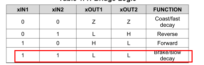

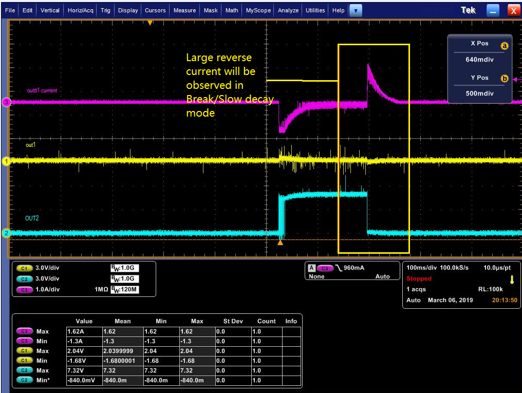

Hi Experts,
Our customer is evaluating our DRV8833 with a brushed DC motor using our EVM, and found that it will observe a large reverse current in Break/Slow decay mode as below picture shown, can you help to check why it will happen? Thanks a lot!
