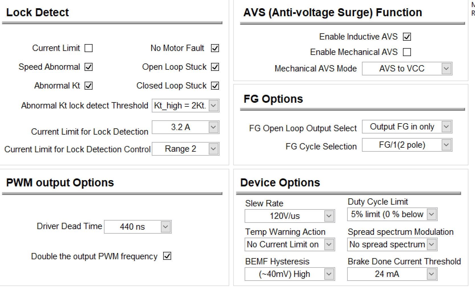

I have the problem, that the fan spins under identical mechanical conditions sometimes with 39500 RPM, but sometimes only with around 35000 RPM. Speed is set to 100%, and also buffered speed is 100%. Additionally, with the given settings, I frequently get an over current lock error, so I had to disable the lock bit to avoid stopping the motor.

    c) the motor starts without problems, also the switch to closed loop is ok. The overcurrent lock occurs shortly before maximum speed is reached, but the real current flowing is clearly below the configured maximum value of 3.2A for Current Limit for Lock Detection.

    1) Can you send an oscilloscope capture of one of the motor phase currents? I want to see what the dint at the peak is and how far it is from the 3.2A.
    2) Some times overcurrent is because of insufficient dead time. I know the tuning guide recommends 440 ns dead time, but try to increase it.

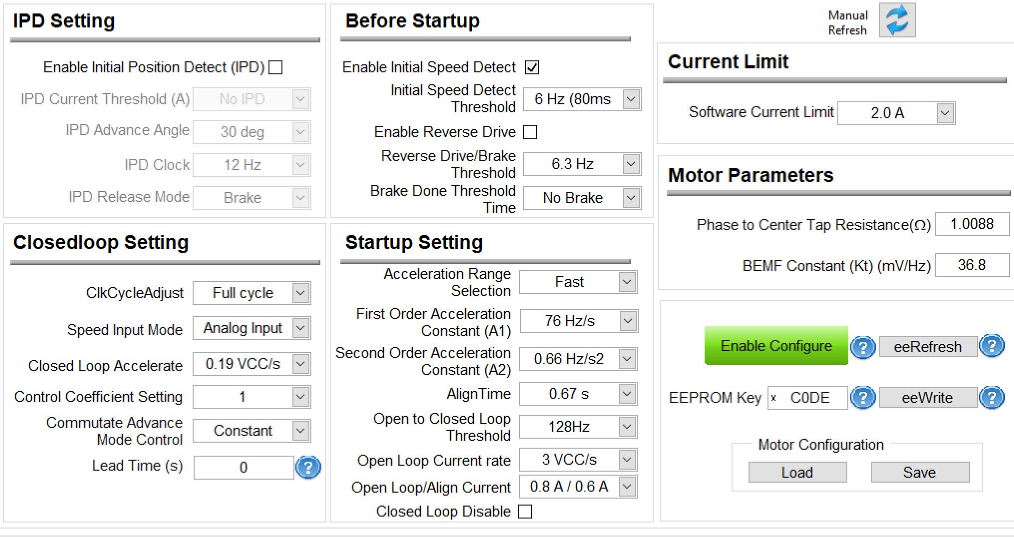

  • Hey Sanmesh,
    I solved the problem today. I measured Kt by measureing  Ep (½ peak-to-peak amplitude) and te (electrical period) while manually spinning the motor. Kt is much lower then the value noted in datasheet. I measured Kt = 25, finally using Kt = 27.
    Second problem was, that the setting of Control Advance Time using the  DRV109xxEVM GUI does not work. There seems to be a bug (Version 3.3.4) . There is only a field named "Lead Time",  which I used to set  T Control Advance. But it did not result in correct register settings.  I now manually set the register by using a CSV-configuration file and loading it into the GUI. This worked. I set the time to 240us.

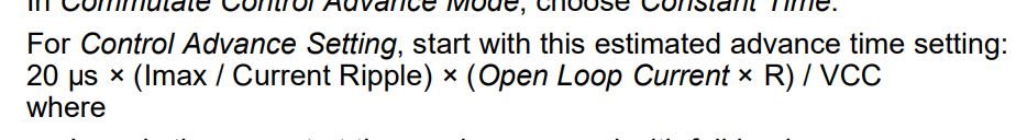

    By the way, equation 5 in tuning guide is unclear:
    T Control Advance(s) ≈ 20 μs × Imax Current Ripple × Open Loop Current × R VCC
    Is there a x (multiplication) between R and VCC? Which units have to be used? [A] , [V], [Ohms] ?

  • 1) Regarding your question about lead angle equation, it looks like in the DRV10987 tuning guide, all the formatting didnt appear. Please use DRV10983 tuning guide as reference for this equation. The equation is supposed to be as shown below.
    2) Lead time is the same as T control advance (s)
