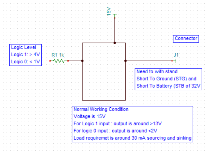

  • Rick,
    Below is the requirement.
    For this one, I have been chosen SN754410. Because input logic voltage (VCC1) is 5V and output  drive voltage (VCC2) is 15V.
    It has thermal protection. If I do STG or STB (to 32V)  , then it will go to thermal protection if temperature goes above 150 C. Then output will be high impedance state. Once cool down it will give the voltage according to input.
    Do you have any other devices to satisfy these requirements.
    Ramakrishna

  • Hi Rick,
    SN754410(-40 to 85 C) and L293 ( 0 to 70 C) are not in our temperature range. I did not get LN293D datasheet.
    I think these devices (DRV8844, DRV8876 , DRV8870, DRV8871 and DRV8872) can not use as single half H-bridge for getting all protection features. Please can you provide your views for using these devices as single half H-Bridge.
    We want very small footprint and low cost also.
    We need 8 half H-Bridge per board.
    Requirements:
    Application: I/O protection.
    Maximum Current : 50 mA
    Maximum Voltage : 32
    DRV8871 is SO-8 package and has ambient temperature of -40 to 125 C but can not use as single half Bridge for getting all benefits. Please can you confirm?
    Ramakrishna Challa
  • Hi Ramakrishna,
    Thanks for the additional information.
    I would recommend you stay with the SN754410 based on your requirements. You are already familiar with the device and its operation.
    To follow up on your comments:
    The L293D is a lower current version of the L293. The L293 datasheet has information for both. As you noticed, the L293 operating temperature is lower.
    Our newer devices include undervoltage protection, thermal shutdown, and overcurrent protection which protects against short to battery and short to gnd. But the cost is not as attractive.
    If price is the main priority, 2x SN754410 is the choice.
    If very small footprint is the priority, 4x DRV8816 may be the choice. The package area of 4x DRV8816 is ~45% of 2x SN754410.
