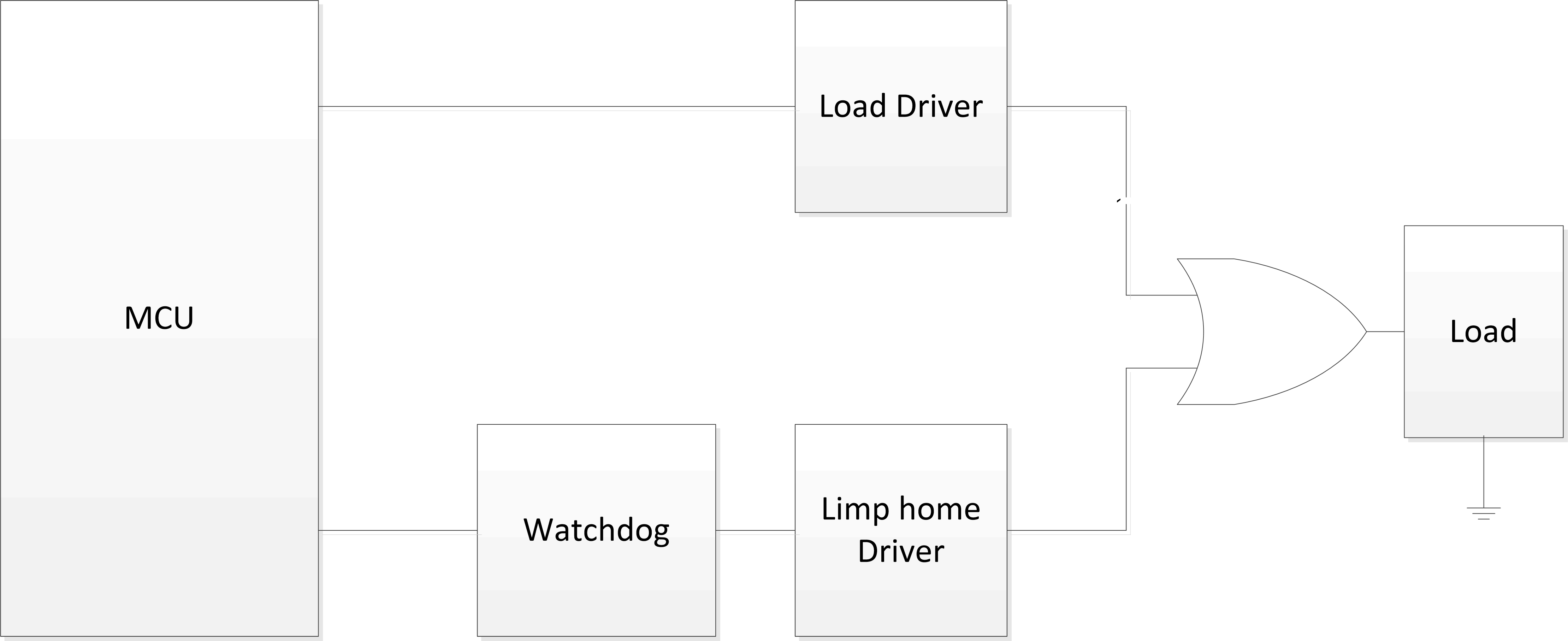

i hope if i could find someone who have some interesting documents could help me for making a good limphome system for vehicle loads
many thanks

Hello mdioud,
I am not clear on what you are asking about. Are you referring to a "Limp-Home Mode", and if so, what specifically about "vehicle load" would this apply to? If not, please provide a high level overview of the overall system and goals.

FYI, this App Note describes "Limp Home Mode" for BLDC motor driver: http://www.ti.com/lit/an/slva939b/slva939b.pdf .
Can you let us know the know the conditions which will trigger limphome mode?
One example condition that could trigger limphome mode in BCMs is MCU failure. In this case, a watchdog is used to detect the MCU failure and then watchdog output + some logic can then be used to drive the load. See below block diagram that illustrates this concept.
See this note (http://www.ti.com/lit/an/snva837/snva837.pdfabout how watchdog output can be latched in order to drive the load.
