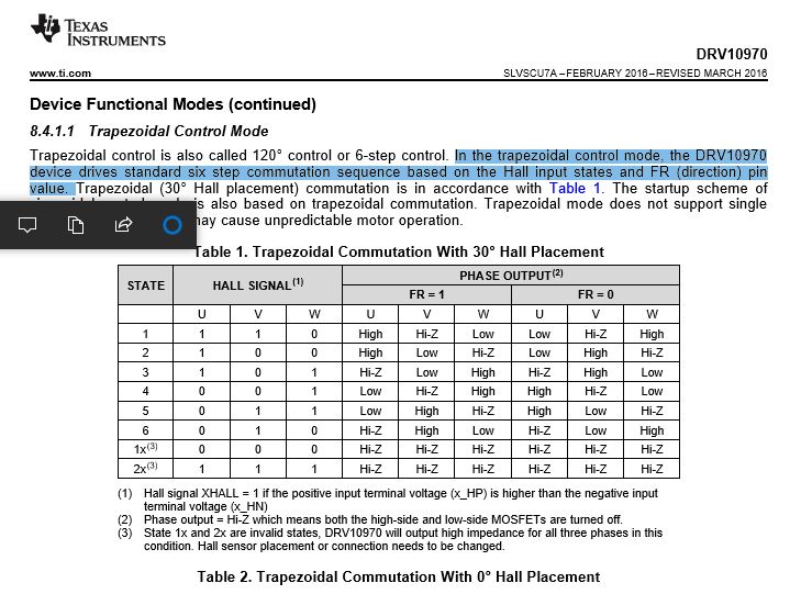

I am using DRV10970 for precision speed control of a three phase BLDC motor (FaullHauber 2610B). According to my understanding of the datasheet, when you switch/toggle the FR pin state, the motor first brakes and then reverses. However, in "8.4.1.1 Trapezoidal Control Mode", it is stated that  "In the trapezoidal control mode, the DRV10970 device drives standard six step commutation sequence based on the Hall input states and FR (direction) pin value." along with the truth table. [Ref : SLVSCU7A, Pg 17, 8.4.1.1]
Is the trapezoidal mode an exception for the FR operation, where changing the FR state directly changes the commutation sequence irrespective of the BRKMOD state.
