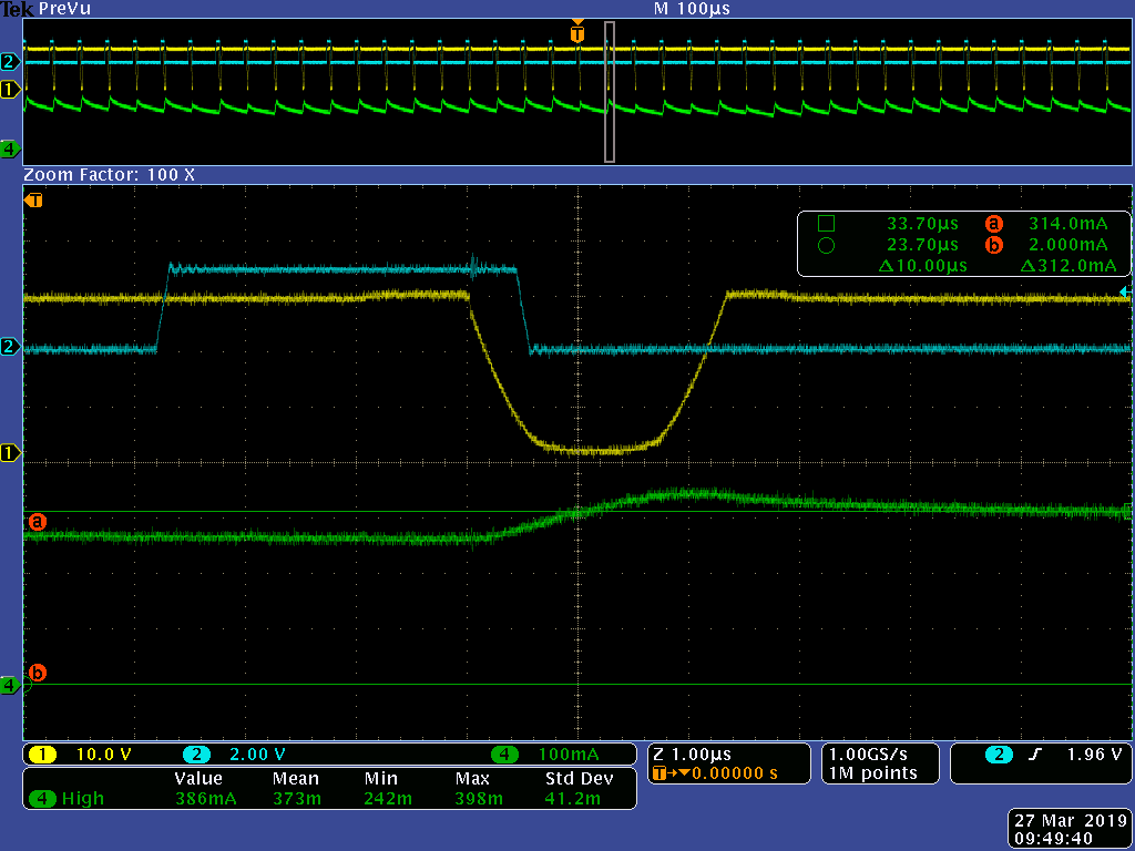

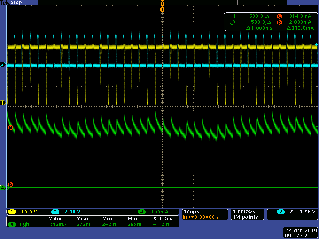

Observations:

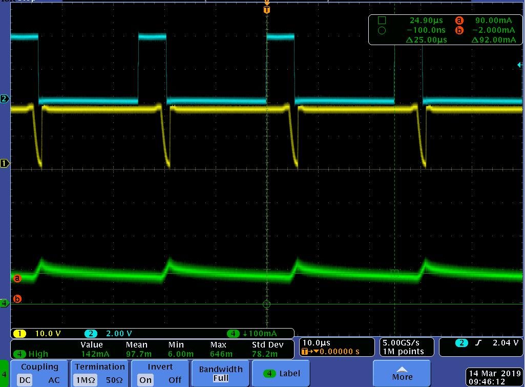

Duty cycle = 22%:
By applying external PWM (blue curve) the motor current (green) increases. The OUT1 (yellow) falling slew rate is around 13V/µs whereas the rising slew rate is much higher.
Duty cycle = 24%:
When the OUT1 seems reach 0V, the driver becomes unstable. The rising slew becomes unstable, the motor current starts to oscillates and the motor starts to vibrate. A video linked was done to show this phenomenon.
Beyond this specific duty cycle, the driver and motor behave well.
This phenomenon was observed first by driving the motor with the GUI software and was reproduced with external PWM control.
This phenomenon is also present in PWM mode by alternating the outputs between H/L and H/H states (does not append in PWM mode by alternating the outputs between H/L and Hi-Z/Hi-Z states).
This phenomenon is much more present with low slew rates configurations and vibrations of the motor are stronger.

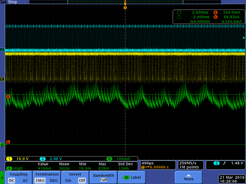

    The motor acts like it is trying to start but does not have enough current at 24%.
    If the customer tries to operate the motor with a DC supply, does the motor behave similarly when ramping the supply between 2 and 6V?
    Would you please ask the customer to capture several individual scope shots at 24% without persistence?
    Also please ask for a zoomed out scope capture (maybe 500us/div). We would like to see if there is a repetitive pattern in the current.

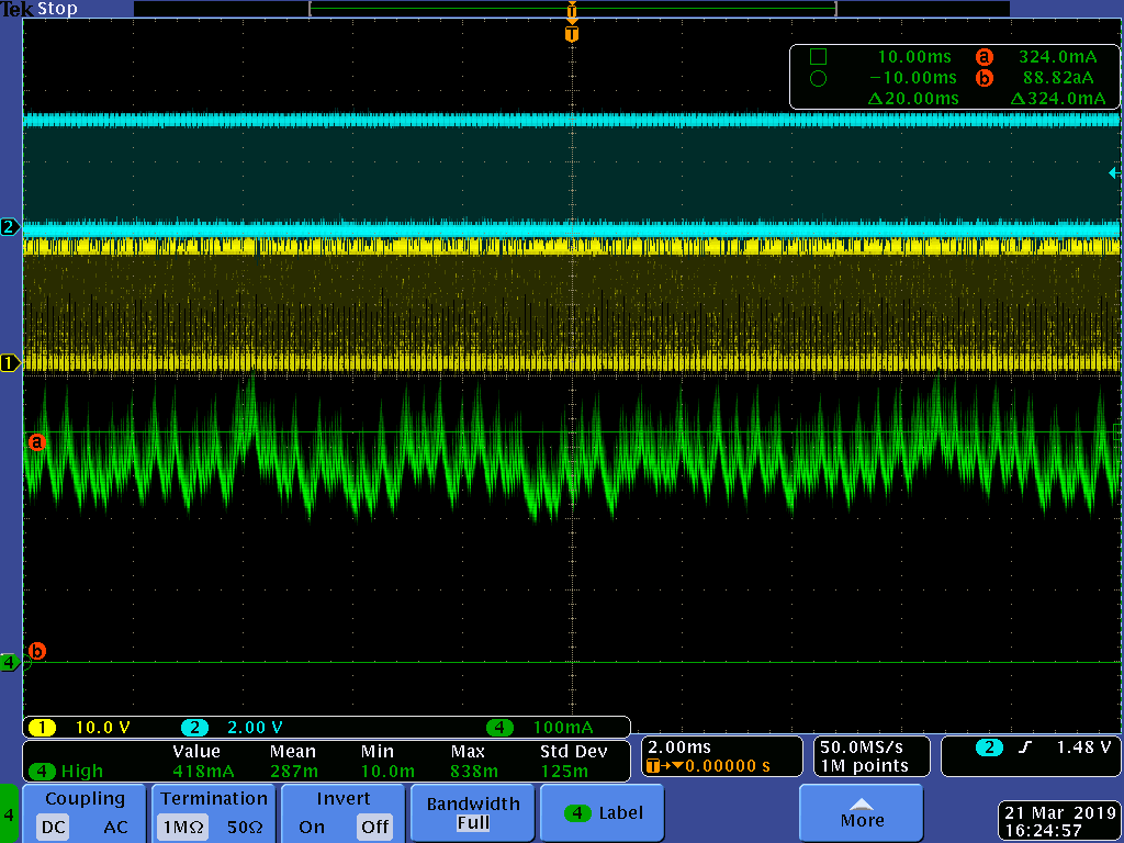

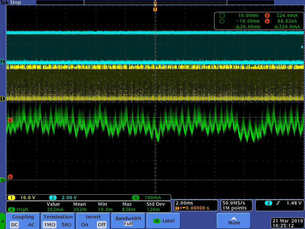

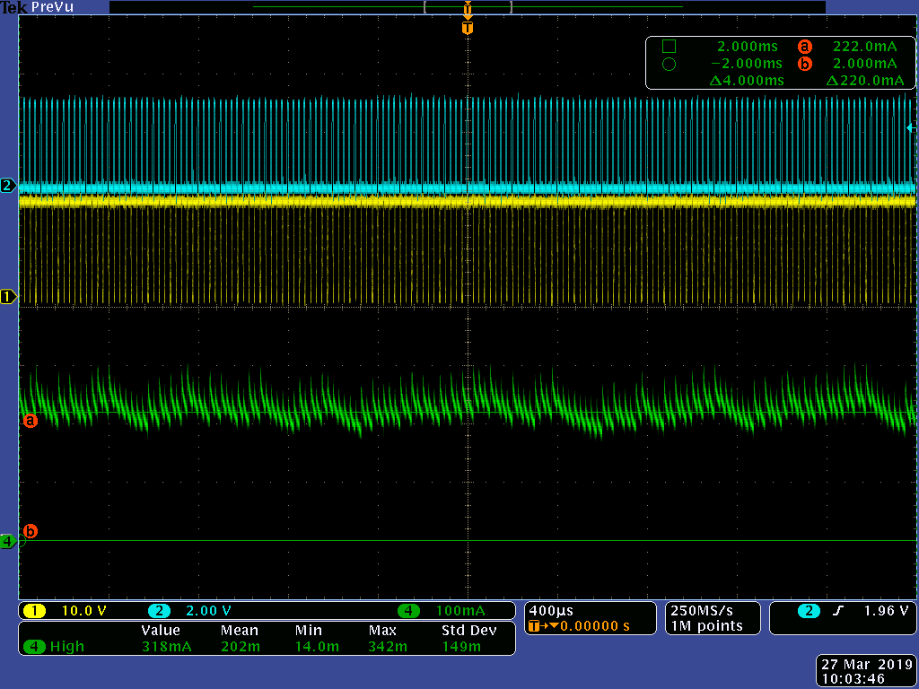

    -> Below are some oscilloscope shots with the same setup at 24%:
    As before, Blue=command, Yellow=OUT1 (OUT2=high), Green=motor current.
    Below are 2 single shots (without persistence) at 2ms scale:

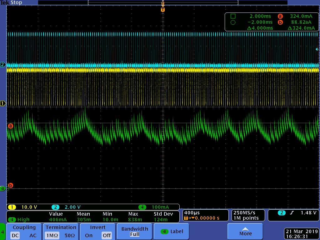

    Below are two single shots (without persistence) at 400µs scale:

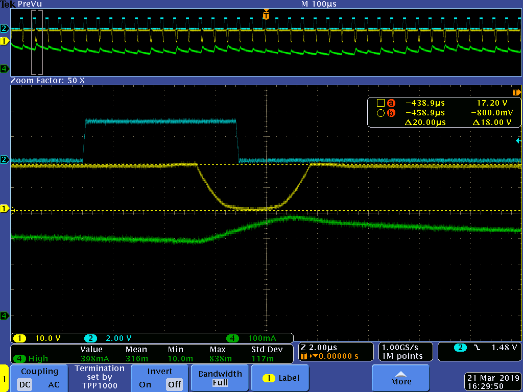

    Below is a single shot (without persistence) at 100µs scale:

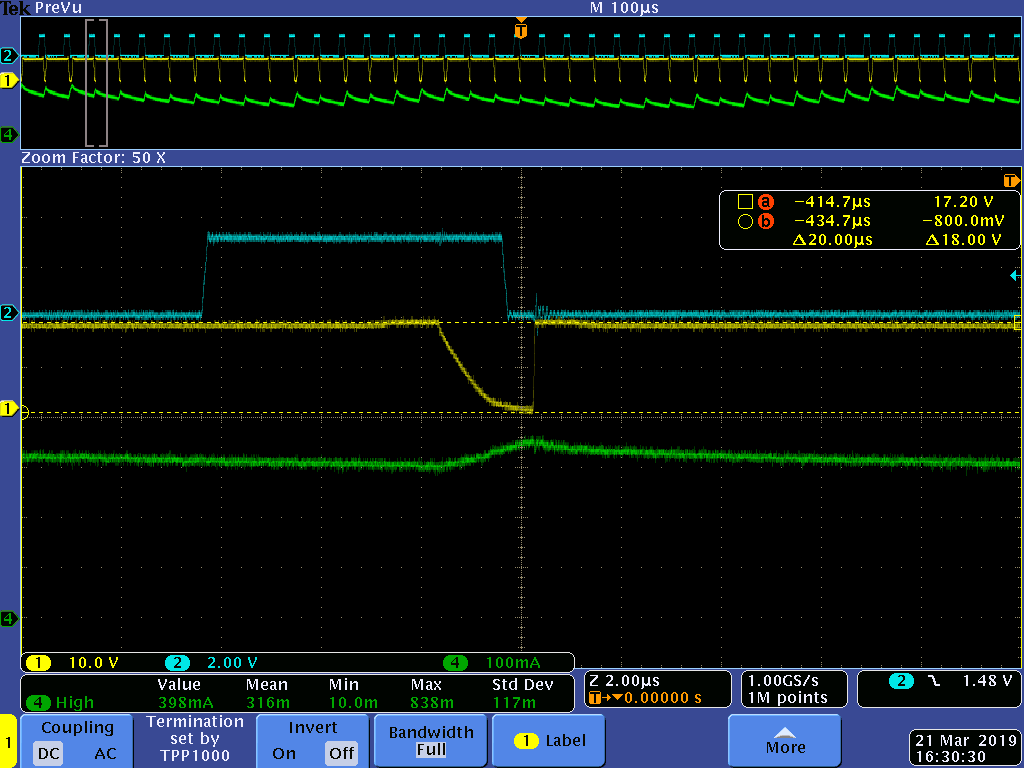

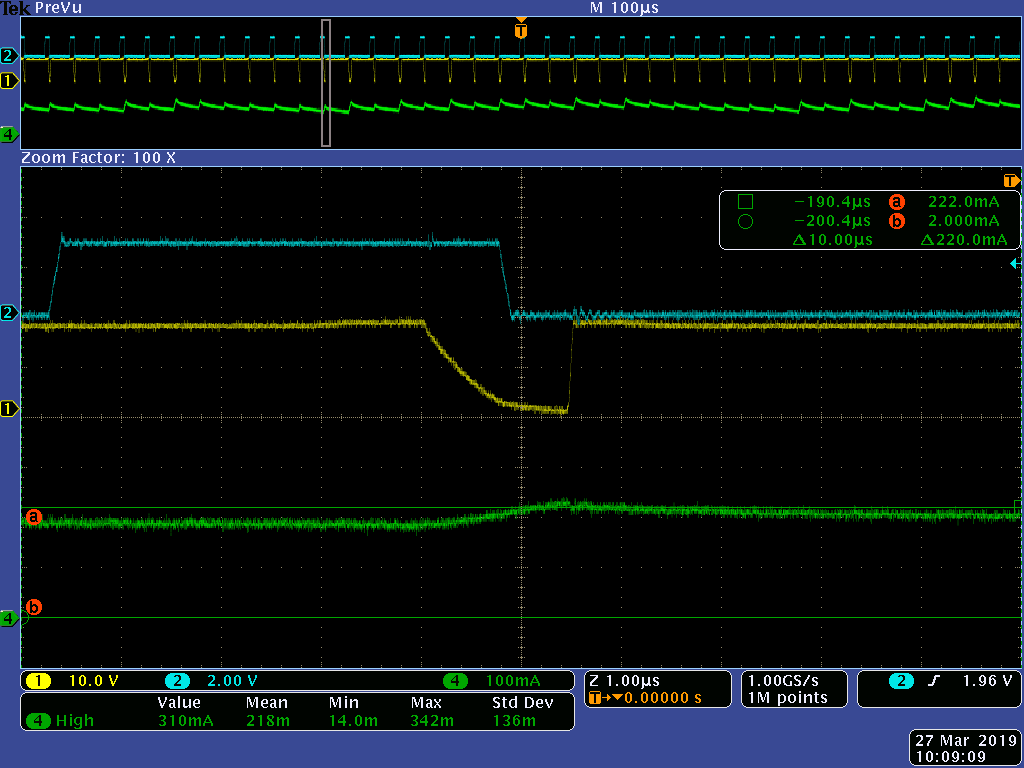

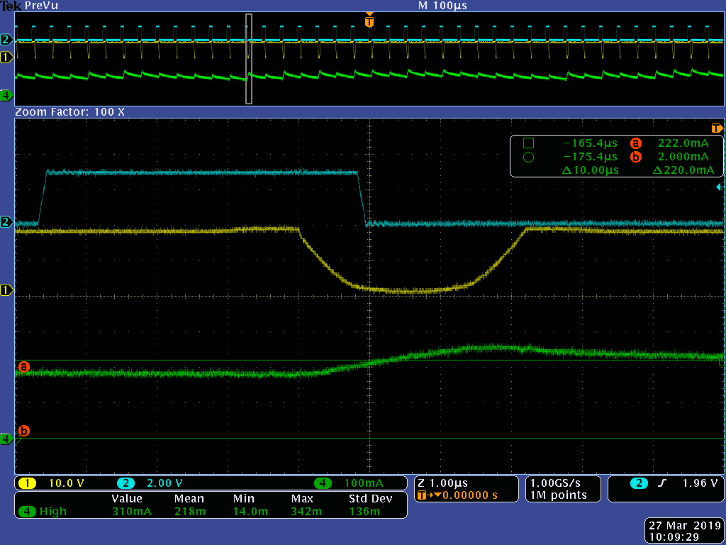

    On the image above at 100µs/div, I looked the rise time on the output transitions. The pattern alternate between fast rise time (1) and slow rise time (0) with the following sequence:
    001111011101000001111111010101000001101
    Below are zoomed image on fast and slow rise times:

  • Hi Alexis,
    The images show that the slew rate and propagation delay appear to change. Both are based on the SR pin.
    Can you try setting the SR to a different value a non Hi-Z value (68k or 22k to GND)?
  • Hi Rick,
    I tried with the 68k config (SR=18,3V/µs), the behavior seems to be the same but less strong, see below:
    400µs scale:
    The rising slew rate alternate between fast and slow:

  • Hi Alexis,
    So this appears to be some type of noise affecting the slew rate. Let me check with the design team to determine if there is a recommendation to reduce the noise. I hope to have an answer by Friday.
  • Hi Alexis,
    After speaking to the design team, it was suggested to try placing a 1nF capacitor on the SR pin as a filter.
    This may be necessary when operating at 7.9, 13, 18.3, or 34 V/us slew rates. It may also depend on layout.
