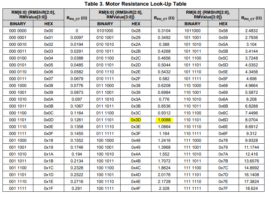

I'm trying to setup the motor parameters for a BLDC pump.
The phase to center tap resistance is measured at 0.5875 Ohms (half of the phase-to-phase resistance).
Looking at the datasheet (table 3), the nearest value would be 0x2F (0.582 Ohms)
But when I try to enter 0.5875 into the GUI, the number automatically jumps to "1" ohms. (this is true for any number less than 1)
The only valid numbers for phase to center tap resistance are full integers between [1..18], except 10 and 15..
How can I setup the board to use 0x2F / 0.528Ohms using the GUI?
Or is there another way I can force the board to use 0x2F as value?

    • I can enter 0,5875 in the field, but as soon as I press tab or click somewhere outside the cell, the value goes to "1".
    • I can not enter 0.5875, the point is ignored. Only comma's are allowed.
    • I can enter 587m in the field, but as soon as I press tab or click somewhere outside the cell, the value goes to "1".
    • I can lower the value using the arrow keys up/down, but as soon as I press tab or click somewhere outside the cell, the value goes to "1".
    • When looking at the logfile, I see that the actual value that is sent to the DRV10983 does not match with the 0.587 value but it matches with 1 (0x3D):
    GUI.write_register("DRV10983Q1","CONFIG1",0x3D)

    Proposed workaround for now: Program that phase to center tap resistance through a script.
    a) Go to "Script" tab and click "Launch Window".
    b) in the launched window, change the Phase to Center Tap Resistance register directly by pasting the following code.
    GUI_Module=__import__('DRV109xx EVM')
    GUI=GUI_Module.Device_GUI("DRV109xx EVM.exe")
    GUI.write_register("DRV10983Q1","CONFIG1",0x2F)
    GUI.read_register("DRV10983Q1","CONFIG1")
    c) To run the program, in the launched window, go to "Run" tab, and click "Run module". Save the program when it asks you too. this should change the register directly.
