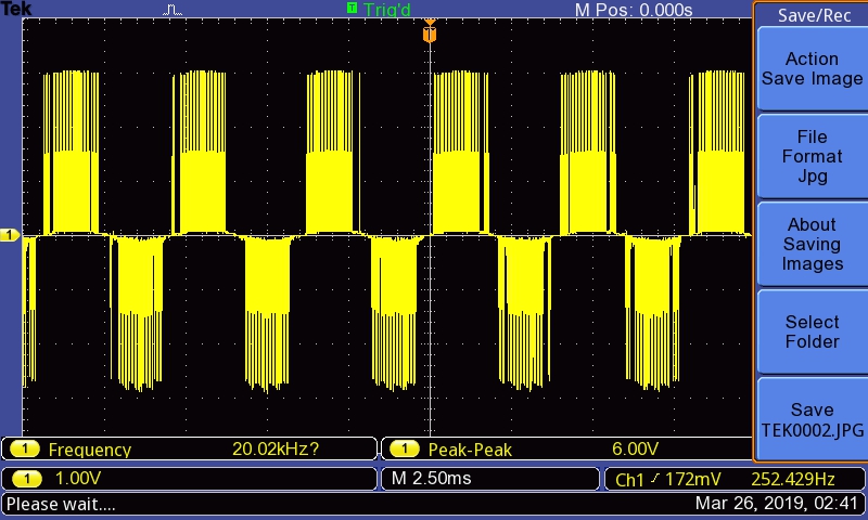

Is it possible to input a sine wave (1.8V peak-peak) and see the same sine wave output from the DRV2605L? Is there a way to define the maximum amplitude of the output? e.g. 1.8V input => 3V output.
I have a sine wave as input to the IN/TRIG pin (1.8V peak to peak at 250Hz)
I have the DRV2605L set up to drive LRAs (0x1A register, N_ERM_LRA = 1)
I am in PWM/ANALOG Mode (0x01 register = 0x03)
I have selected analog input (0x1D register = 0xA3)
I get the following output:
  • Hi, Stephen,
    Welcome to E2E and thank you for your interest in our products!
    It is possible to get the same waveform from the differential output (OUT+   minus   OUT -). However, you would require to configure the device to drive the LRA load in open-loop mode. In addition, you would need to reduce the overdrive voltage (around 1Vdc) since the output voltage may result in a high voltage.
    Please take a look at the attached script, it is an example of a configuration that uses a sine waveform at the IN/TRIG input.

  • HI,
    I tried setting all the registers as per your reply, but the output from the DRV2605 is as shown below. Any suggestions for what I should try next?
    Cheers
    Stephen
  • Hi, Stephen,
    I made more testing on our evaluation modules and it seems that the output signal won't be exactly the same waveform than the input signal. You may get an approached signal with the help of a Class-D filter (RC filter, R = 100ohms, C = 0.047uF suggested). The frequency will be also approached and the voltage must be modified by the DRV2605L registers.
