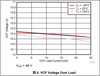

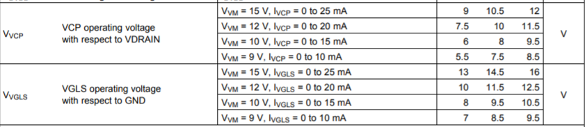

DRV8353: How much is Vvcp at 48V of Vvm?
Guru 11255 points
Hi team.
I'd like to know about Vvcp.
How much is max and min voltage of Vvcp , when Vvm is 48V ?
I can not determine the correct value of Vvcp, because I can't see the correct values from below the graph.
Sincerely.
Kengo.
