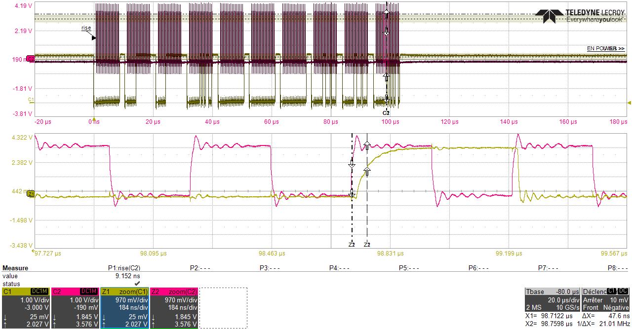

We have a question regarding the SDO output characteristics of the DRV8320.
The datasheet is stating Td(SDO) SDO output delay time at 30ns.
Is that pure internal delay ie. time to drive the gate of the open drain internal mosfet or does it take into account the rise time outside of the component ?
We are asking this question as the datasheet does not provide the test conditions that led to the timing stated in the datasheet.
To ensure our design works, which was not the case at the beginning due to link frequency vs rise time, we did some tests with different pull-up values as highlighted in the below screenshots (don't pay attention to the labels, the yellow one is the clock and the purple one the sdo).
With a 4.99k:
With a 1k:
If the datasheet doesn't take into accout the rise time, it misses an information on the output capacitance of the DRV8320 which would allow us to compute it.
From our tests, we assume it's about 75pf/80pf (which is important compared to the TMS320F28377D input capacitance we have in front + the track capacitance).
Though we are able to have it working, I have concerns regarding min/max as we are performing our tests here at ambient temperature and we can't justify without further inputs from you our worst case analysis.

  • Hi Clément,
    The 30ns is the max time it takes between the rising edge of the clock and the open drain output of the SDO to turn off across all units and all temperature. Then the RC time constant of the pull up determines how fast the SDO voltage can rise. We do not spec our SDO capacitance for the device. It looks from your testing that your capacitance on the SDO is about 40 or 50 pF from my calculations. What SPI rate are you trying to run this at?

  • Hi Clément,
    On SDO we will typically have 15 pf of capacitance and have a maximum of 20 pf of capacitance.
