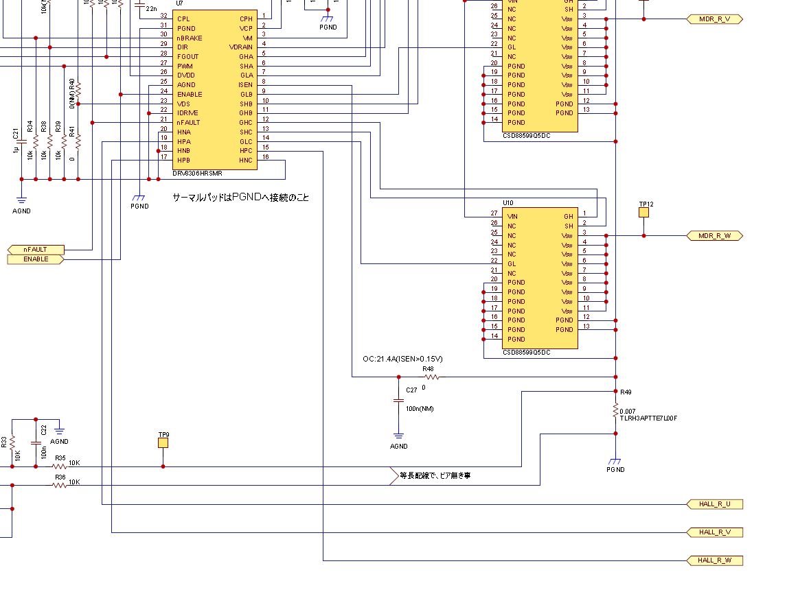

The Internal regulator is not output(DVDD 26pin) even though the VM is supplied(15V).
Would you please let me know the cause of that?
Actually, the load current of the main power supply is almost zero, and nFAULT is low at the time(immediately after power on).
I'd appreciate your help.
