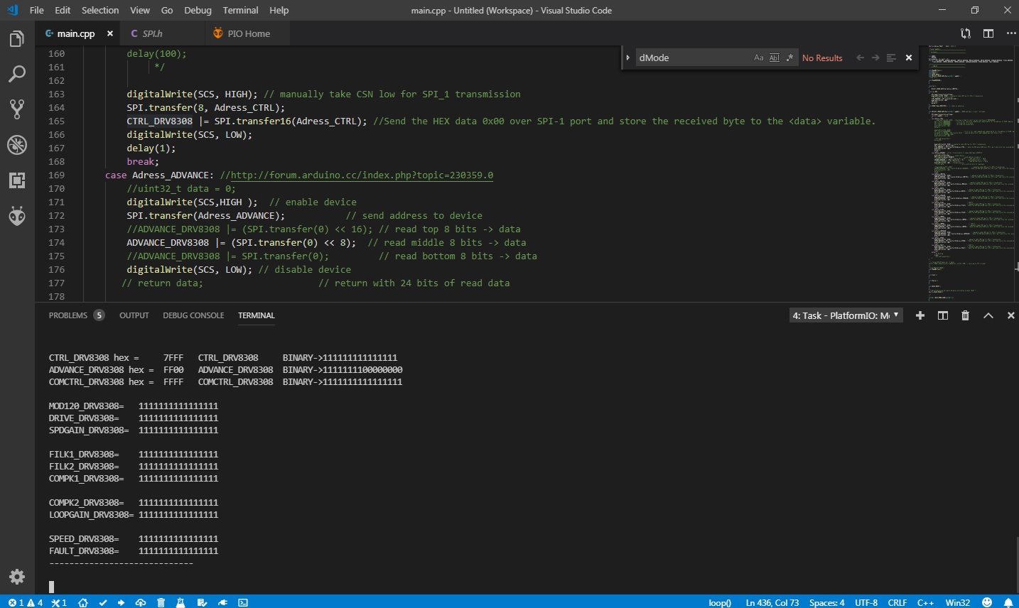

  • //Mode Clock Polarity (CPOL) Clock Phase (CPHA)
    //SPI_MODE0 0 0
    //SPI_MODE1 0 1
    //SPI_MODE2 1 0
    //SPI_MODE3 1 1
    SPISettings settings(1000000, MSBFIRST, SPI_MODE0);
    void setup()
    Serial.begin(115200);
    SPIClass(MOSI,MISO,SCLK,SCS);
    SPI.beginTransaction(settings);
    pinMode(SCS, OUTPUT);
    to read and save the bits on variable COMCTRL_DRV8308 to print
    Adress_COMCTRL =0x00
    case Adress_COMCTRL:
    digitalWrite(SCS, HIGH);
    COMCTRL_DRV8308 = SPI.transfer16(Adress_COMCTRL);
    digitalWrite(SCS, LOW);
    break;
    i have always the same values on picture
    i need help
  • Esmith,
    I cannot help you with this unfortunately. Please post on a code forum or the stm32F103RB forum.
    -Adam
