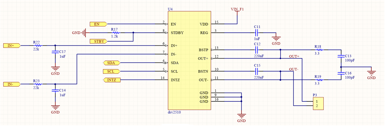

Dear TI friends,
Using drv2510 to drive a little dc motor I get a failure interrupt exactly every two seconds, and the output power is cutted off.
I read the registers through I2C, and I get the fault bit at bit 4 address 0x02, but there is not fault details at address 0x01 (all bits are 0).
Could you give me a clue of what is happening?
