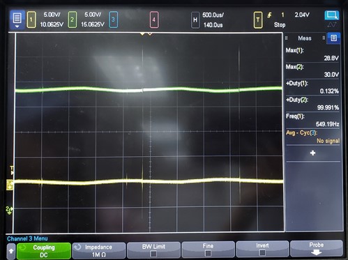

I am using the DRV8816 Motor Driver to control a 24V Brushed DC Motor (inside of a linear actuator). I am noticing issues with low side not being pulled low all the time.
In the first case, I have both EN lines pulled HIGH (3.3V). I have IN1 LOW (GND) and IN2 HIGH (3.3V), so I expect OUT1 to be LOW (0V) and OUT2 to be HIGH (24V). However, I notice that OUT1 will pulse HIGH at times. See first picture and second picture for a zoomed in view of the pulse. OUT1 is yellow and OUT2 is green. The motor will still drive, but I am wondering why is this happening? And is there anything I can do to get rid of this effect?
As a followup, I also tried to PWM the inputs and the behavior is even more noticeable. Again I have both EN lines pulled HIGH (3.3V). In the first picture, I have IN1 LOW (GND) and IN2 being PWM (0V to 3.3V) at a 50% duty cycle and 10kHz frequency. You can see OUT2 is being PWMed as expected, but OUT1 is pulsing HIGH at the same time OUT2 goes HIGH. In the second picture, I have IN1 being PWM (0V to 3.3V) at a 50% duty cycle and 10kHz frequency and OUT2 LOW (GND). Again, OUT1 is being PWMed as expected, but OUT2 is pulsing HIGH. Additionally, if I increase the frequency of the PWM signal that seems to increase the period the time the outputs pulse high for.
Can anyone explain to me what is happening and how to solve this issues?

  • Hi Grace,
    The first image shows what appears to be an overcurrent event. Please check the nFAULT signal. With a pullup resistor on nFAULT, the nFAULT is probably going low for ~1.6ms (tocp).
    If this is occurring, please look for a capacitor on the motor leads or inside the motor. The capacitor is usually the cause of this overcurrent event.
    It can also be the inductance of the motor is very low allowing the current to rise very quickly when stalled.

  • Hi Rick,
    I am fairly confident it is not an overcurrent event. I have the entire system hooked up to a power supply with the current limit set to 1A which is far lower than the 3A Iocp (I do not have a SENSE resistor so default overcurrent limit should be 3A). The maximum current draw I observe as well on the power supply is approximately 0.6A when the motor is moving in either direction. I have also checked the nFAULT signal which I have pulled up to 3.3V with a 1.8k resistor. It is always a constant 1.2V (weird that it is not 3.3V, but it definitely is constant).
    Additionally, since the motor is housed within a linear actuator unit, I have no access to the motor itself and cannot change it or check for any capacitor.

  • Hi Grace,
    Please provide a scope capture with the nFAULT pin in addition to the behavior in the first image. This will help rule out an overcurrent event. A local bulk capacitor can provide the current during an overcurrent event. The peak current during the overcurrent event can be >3A, but the average current will be much lower.
    "Is it an inherent part of the motor driver that the outputs must default idle HIGH in the brake state?"
    The DRV8816 can set the outputs both high or both low in the brake state. Please refer to Table 3 of the datasheet.
  • Hi Rick,
    Here is a scope image of the same situation as the first image, and then a zoomed in view with the nFAULT pin in blue. As you can see, this does not appear to be an overcurrent event because the nFAULT pin does not follow normal fault behavior. It's barely even a few microseconds.
    I ask if the outputs must default idle HIGH because I am following the table in the datasheet and according to the behavior I am observing they don't seem to remain low when inputs are low but always do remain high when inputs are high.

    Please look again at the picture. As I stated before, I have the nFAULT signal pulled up to 3.3V with a 1.8k resistor. On the scope I have it set up to 5V/div so that all the signals can fit on one scope and the ground level for the blue signal is indicated on the very left. So nFAULT signal is high and only drops low for a few microseconds. Thus, it is not following the normal fault behavior and is why I am asking this question.

  • Hi Rick,
    I am currently using my own board. Right now I am still in the prototyping phase so it's just a protoboard. Below is a picture of what my protoboard setup looks like. On the left is just voltage converter from 24V to 3.3V and the DRV8816 is connected in the middle.
    Here is a schematic of how I am currently connecting the DRV8816 IC. The input/output ports go to header pins which I then connect to either 3.3V, GND, or the PWM signal (from waveform generator). OUT1 and OUT2 go to the motor.
    No, when the device has no load it operates perfectly fine.
    Here is a scope capture of IN1 (green, PWM at 20kHz, 30% duty cycle), OUT1 (yellow), and nFAULT (blue) with no load.
    Here is a scope capture of IN1 (green, PWM at 20kHz, 30% duty cycle), OUT1 (yellow), and nFAULT (blue) with motor loaded.
    My original question has to do with why the output signal that is not being PWMed is not able to be held steady at 0V even when its input is tied to ground.
