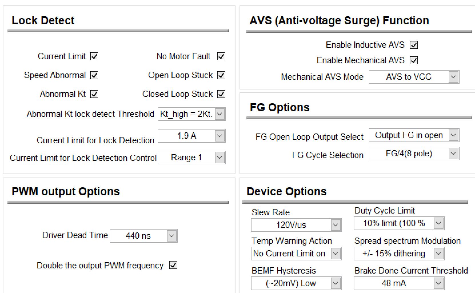

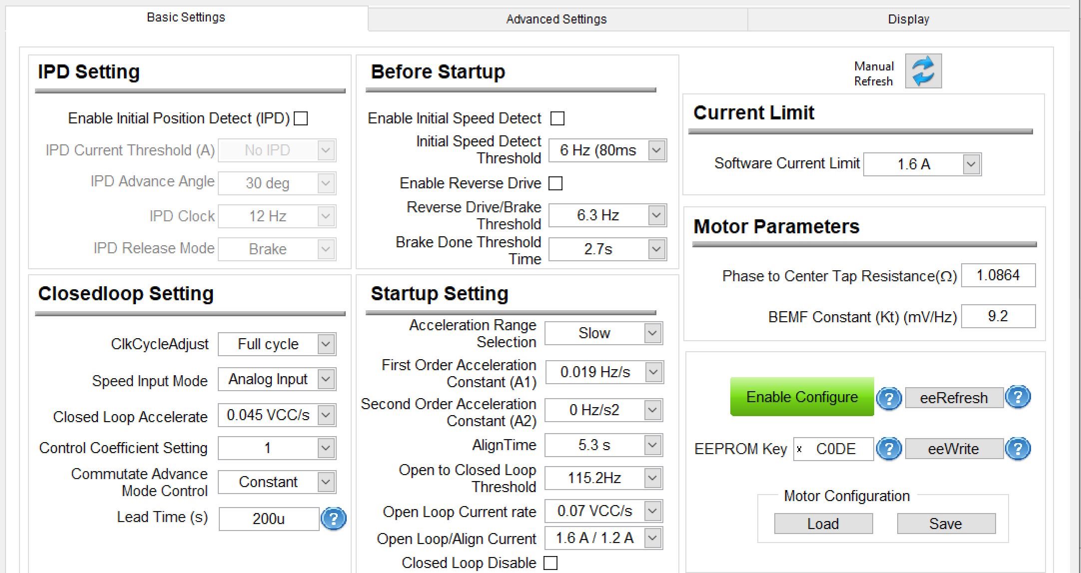

  • 1) I am not sure if DRV10987 can spin motor up to 2000 Hz. I would think it would be unlikely since it is 2x the max frequency we recommend. I mentioned in the previous posts what causes the limitations of the max speed motor can be driven.
    If you want to try seeing if you can spin up to the speed, please try the settings attached below that you can load into the GUI or you can open as a csv to see what the register settings are.
    user5945607e2eSettings.csv
    Also picture of the settings are below. They are conservative settings, to give you the most likely probability of spinnign properly, but they may need adjustments. Also make sure the phase resistance entered is the phase to center tap resistance, not the phase to phase resistance.
