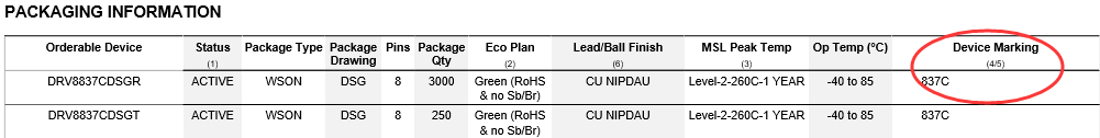

  • Hi Rick
    I have find the DRV8837's device marking is "837C" , does it have any meaning/ indication ?
    According to note 4, it maybe additional marking, so I want to know all Marking info , and tell me what it respective means
    My customer want to know how to recognise device info through device marking ,sush as LOT,Date Code,
  • Hi Fandy,
    There is a limit to the number of characters per line. 837C is the last four characters of "DRV8837C"
    The Lot Trace Code is a 7-digit code marked on each TI device representing a single lot processed through one controlled assembly flow. It might appear in a single line or double line. The code is located with the markings on the top side of the device.
    For the DRV8837, line 2 is 3 characters and line 3 is 4
    Please refer to Figure 6 of www.ti.com/.../szza020c.pdf for more details. Although the application report is for other device, Format 2 is used for the DRV8837C
