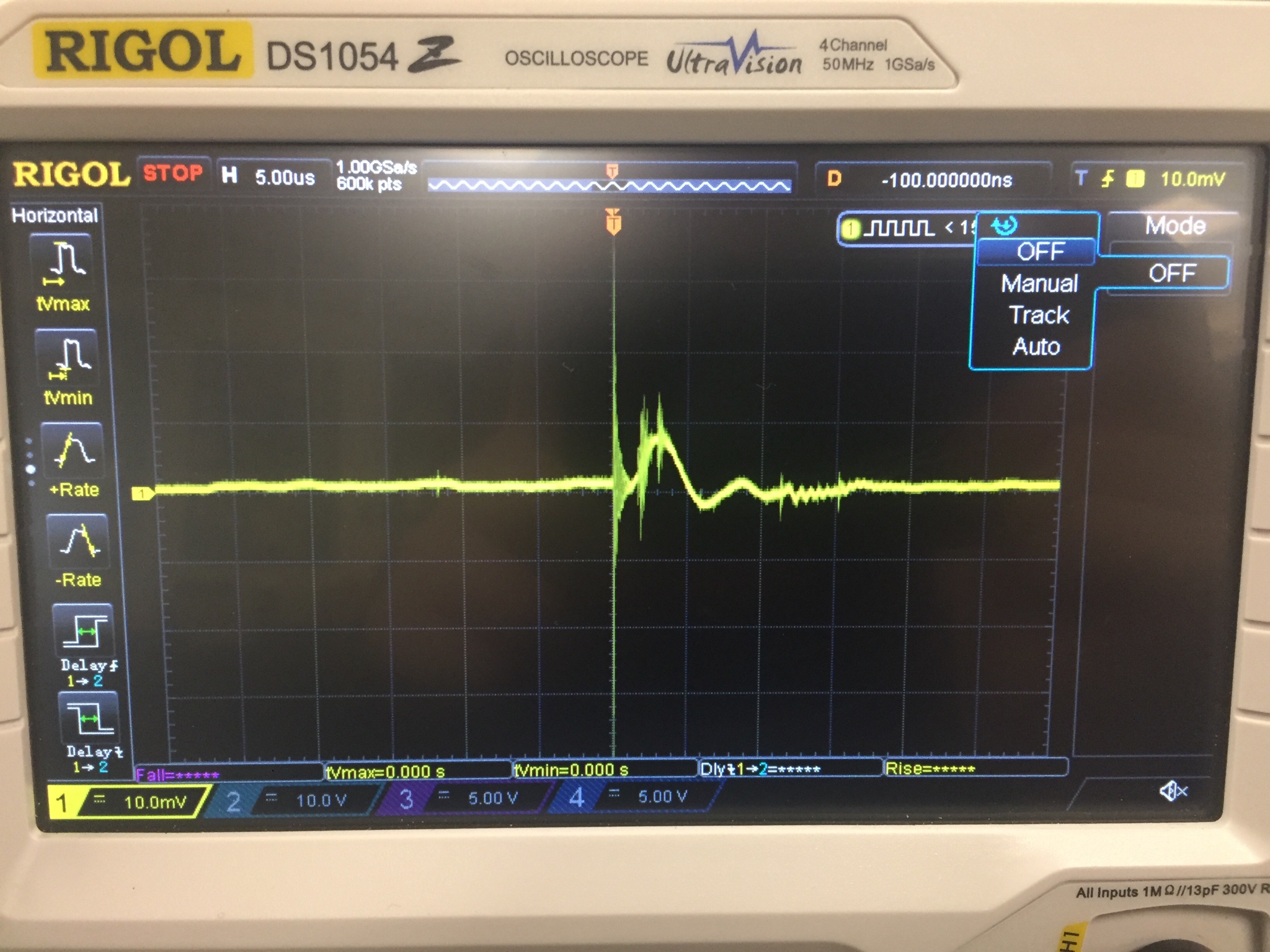

  • Hi Adam,
    Sorry for the delay. I tested the supply current, and it goes to 270 mA on startup for 50 ns, and then goes to 50mA for a ~200 ns longer amount of time, before going back to zero. I removed main input capacitors and probe the main line, with a supply input of 12v(Don't have 48V power supply).
    Edit: here is the scope from another attempt, 1mV/10mA probe. (this was on the enabling of ENGATE)
    Jack
  • Jack,
    Can you summarize for me, what is the steady state current before you trigger the ENABLE of the DRV and after you trigger the ENABLE?
    -Adam
  • Sorry. Before ENABLE is triggered, it hangs around 10mA, and after it jumps around(image of scope above) it drops back down to around 10mA. Inductor was removed, and 5V power was supplied from USB for the microcontroller.
    Jack
  • Jack,
    Are you checking for a fault? if the current is increasing and then dying back down to the 10mA level after ENABLE is triggered, the part may be going into fault condition.
    Did you ever try this on a second device?
    -Adam
  • Yes, it is high on nFault. It has never stopped. I have not tried the second chip yet, I still have to figure out how to hand solder VQFN-48.
