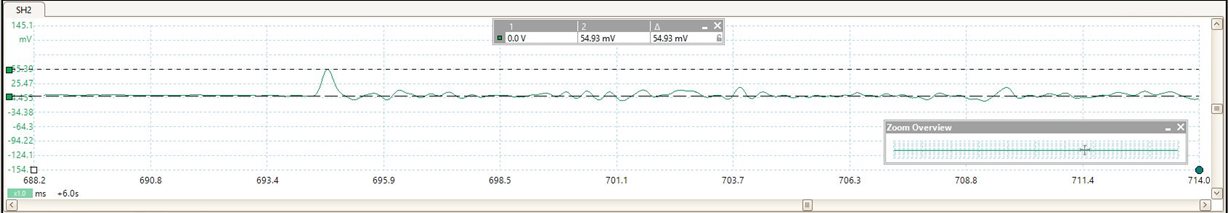

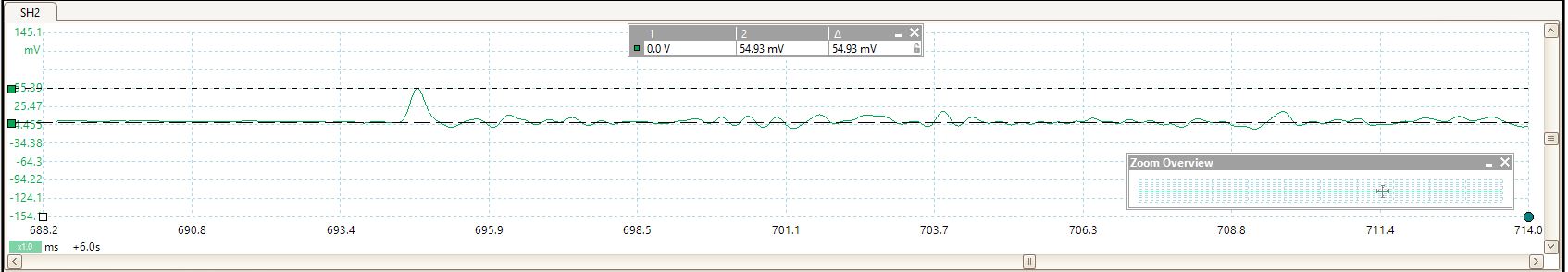

I’m hoping that you might be able to provide us with some insight to some behaviour on the DRV8701 that isn’t documented in the datasheet.

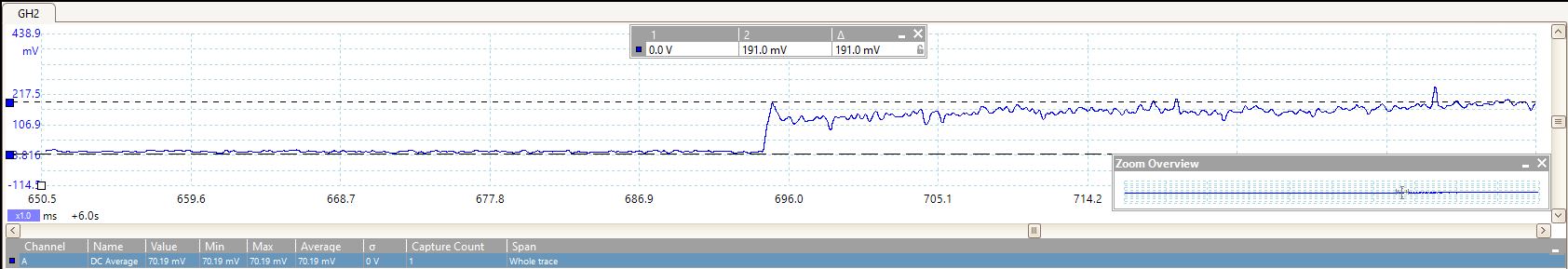

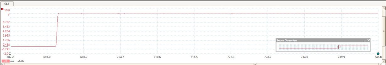

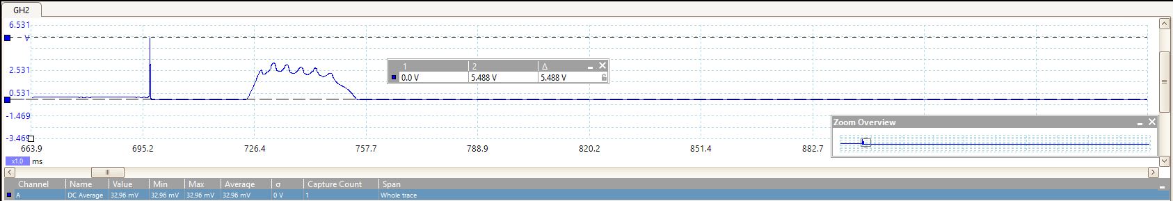

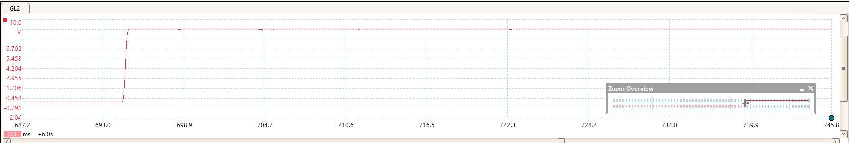

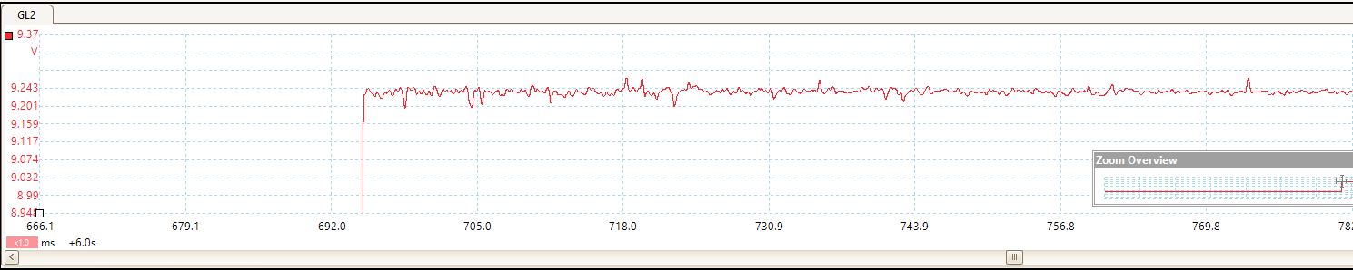

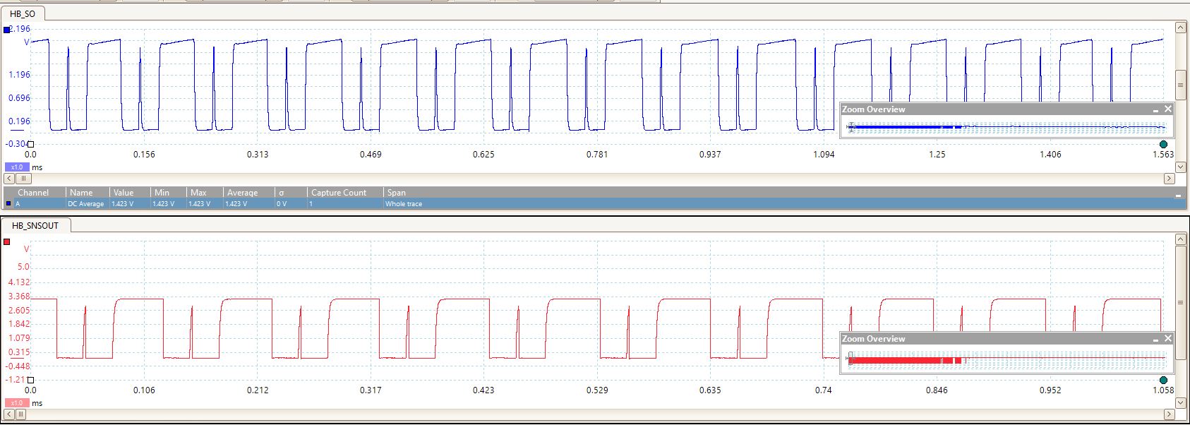

 See below for traces of the SO and SNSOUT signals. We’re curious if the intermediate spikes are something we should dive deeper into. We recently dropped our VREF voltage and increased the SP:SN resistance in an effort to reduce peak current draw when running the compressor. These intermediate spikes go away as the tank pressure increases, but are present right after the H-Bridge starts up for a few hundred milliseconds.
 Would appreciate any insight you could provide.
 See attachment for traces.  NOTE: [Attachment removed]
